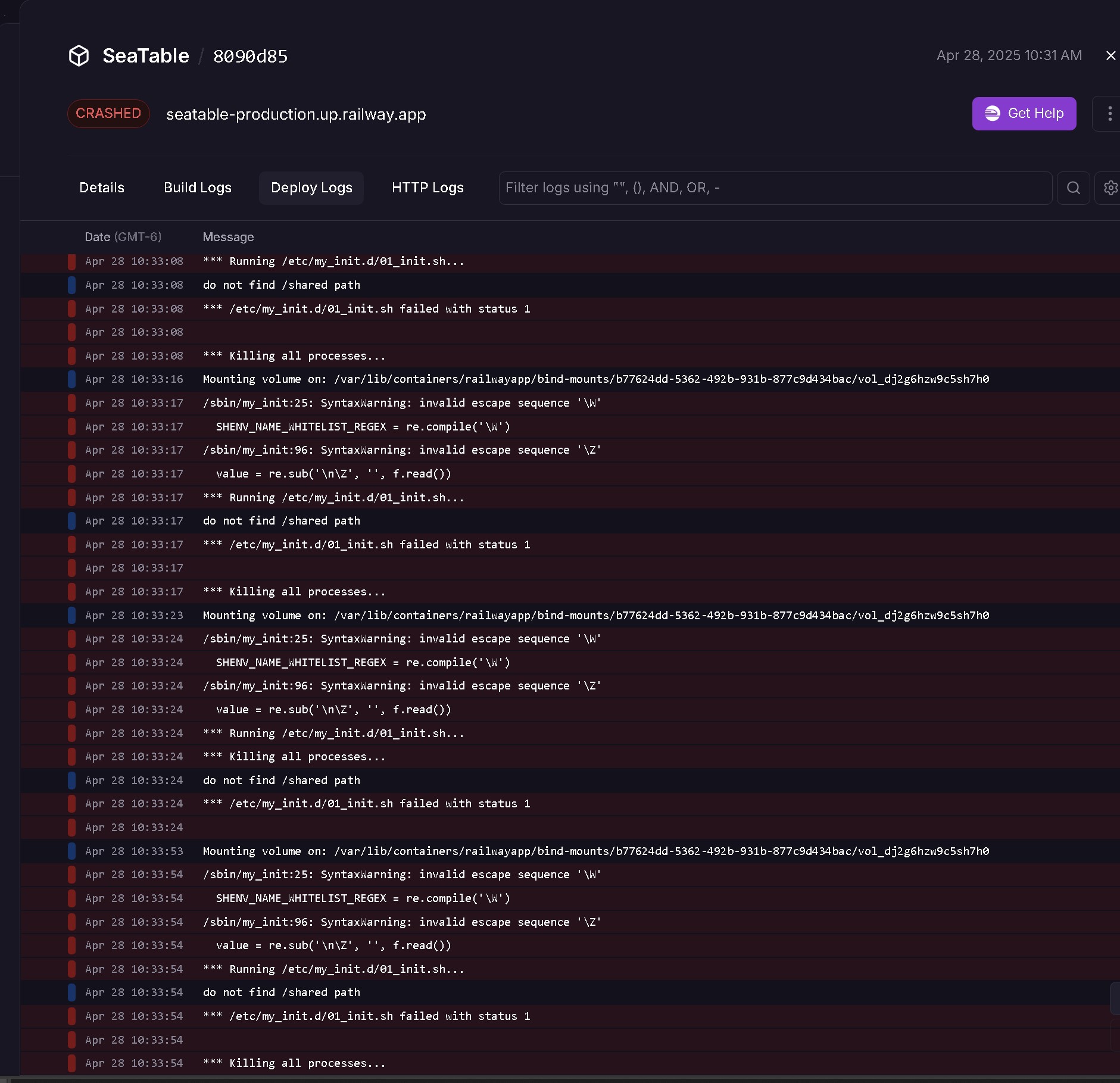

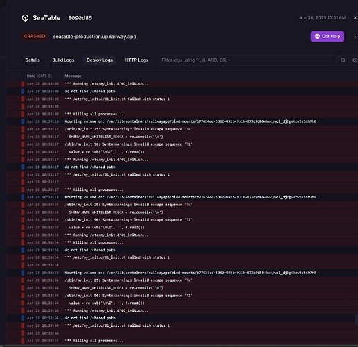

"do not find /shared path" Failed to install on RAILWAY
I’m having trouble installing on Railway.
I see there is no one who talks about this.
hardawre 4CPUs 8RAM
I started with a 10Gigas disc
(only to do the installation test and then increase the Disk capacity to 50 which is recommended)
I can’t get past this mistake.
I have technically resorted to support Gemini 2.5PRO an excellent companion, but has not been able to resolve.
SeaTable Server - SeaTable Admin Manual
The disk volume is mounted on this path
/opt/seatable/seatable-data
I’m trying to install the images :
seatable/seatable-enterprise:latest
seatable/seatable-enterprise:5.2.7
seatable/seatable-enterprise:5.1.9
Mounting volume on: /var/lib/containers/railwayapp/bind-mounts/b77624dd-5362-492b-931b-877c9d434bac/vol_dj2g6hzw9c5sh7h0
Apr 28 10:33:54
/sbin/my_init:25: SyntaxWarning: invalid escape sequence ‘\W’
Apr 28 10:33:54
SHENV_NAME_WHITELIST_REGEX = re.compile(‘\W’)
Apr 28 10:33:54
/sbin/my_init:96: SyntaxWarning: invalid escape sequence ‘\Z’
Apr 28 10:33:54
value = re.sub(‘\n\Z’, ‘’, f.read())
Apr 28 10:33:54
*** Running /etc/my_init.d/01_init.sh…
Apr 28 10:33:54
Apr 28 10:33:54
*** /etc/my_init.d/01_init.sh failed with status 1
Apr 28 10:33:54
Apr 28 10:33:54
*** Killing all processes…

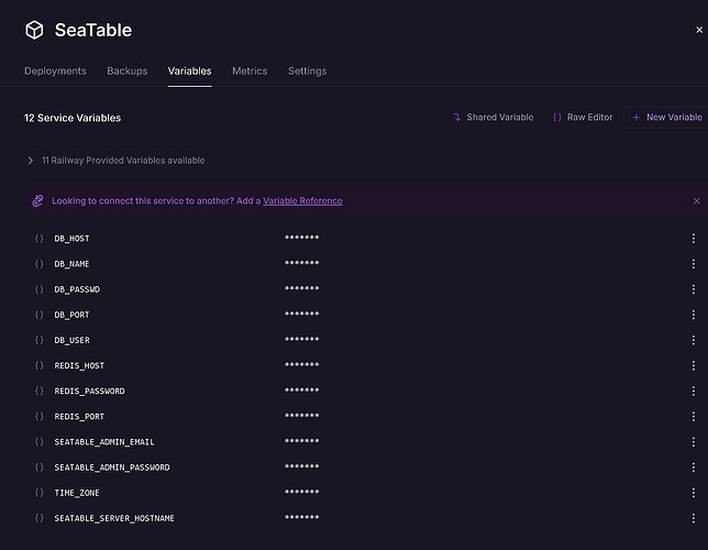

I have these variables declared
DB_HOST=“${{MySQL.MYSQLHOST}}”
DB_NAME=“${{MySQL.MYSQLDATABASE}}”
DB_PASSWD=“${{MySQL.MYSQLPASSWORD}}”
DB_PORT=“${{MySQL.MYSQLPORT}}”
DB_USER=“${{MySQL.MYSQLUSER}}”
REDIS_HOST=“${{Redis-bB_W.REDISHOST}}”
REDIS_PASSWORD=“${{Redis-bB_W.REDISPASSWORD}}”
REDIS_PORT=“${{Redis-bB_W.REDISPORT}}”
SEATABLE_ADMIN_EMAIL=“my email”
SEATABLE_ADMIN_PASSWORD=“my pass”
TIME_ZONE=“America/Monterrey”
SEATABLE_SERVER_HOSTNAME=“seatable-production.up.railway.app”
Can you help me with any suggestions to solve the problem?
Thank you in advance for your attention to this message

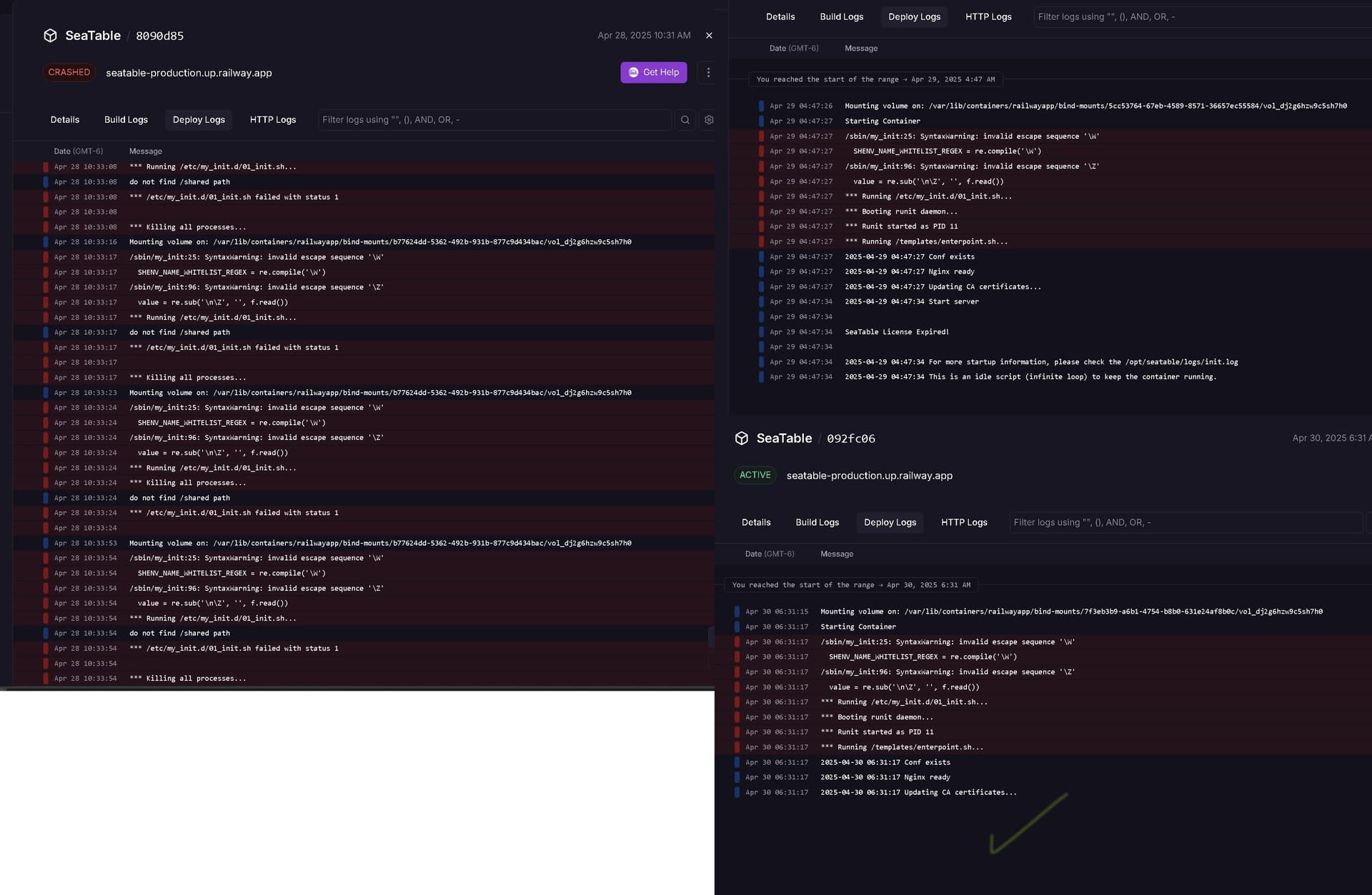

And this is my log.
Mounting volume on: /var/lib/containers/railwayapp/bind-mounts/c9692b8b-17cb-4e0e-aab6-0dcef34f9059/vol_dj2g6hzw9c5sh7h0
Starting Container
*** Booting runit daemon…
*** Runit started as PID 11
*** Running /templates/enterpoint.sh…
2025-04-29 03:09:35 Conf exists
2025-04-29 03:09:35 Nginx ready
2025-04-29 03:09:35 Updating CA certificates…
2025-04-29 03:09:41 Start server
SeaTable License Expired!
2025-04-29 03:09:41 For more startup information, please check the /opt/seatable/logs/init.log
2025-04-29 03:09:41 This is an idle script (infinite loop) to keep the container running.
Log stream has been paused
Resume Log Stream
I’m still having other problems that I don’t know what they are.
Thank you very much for the help.

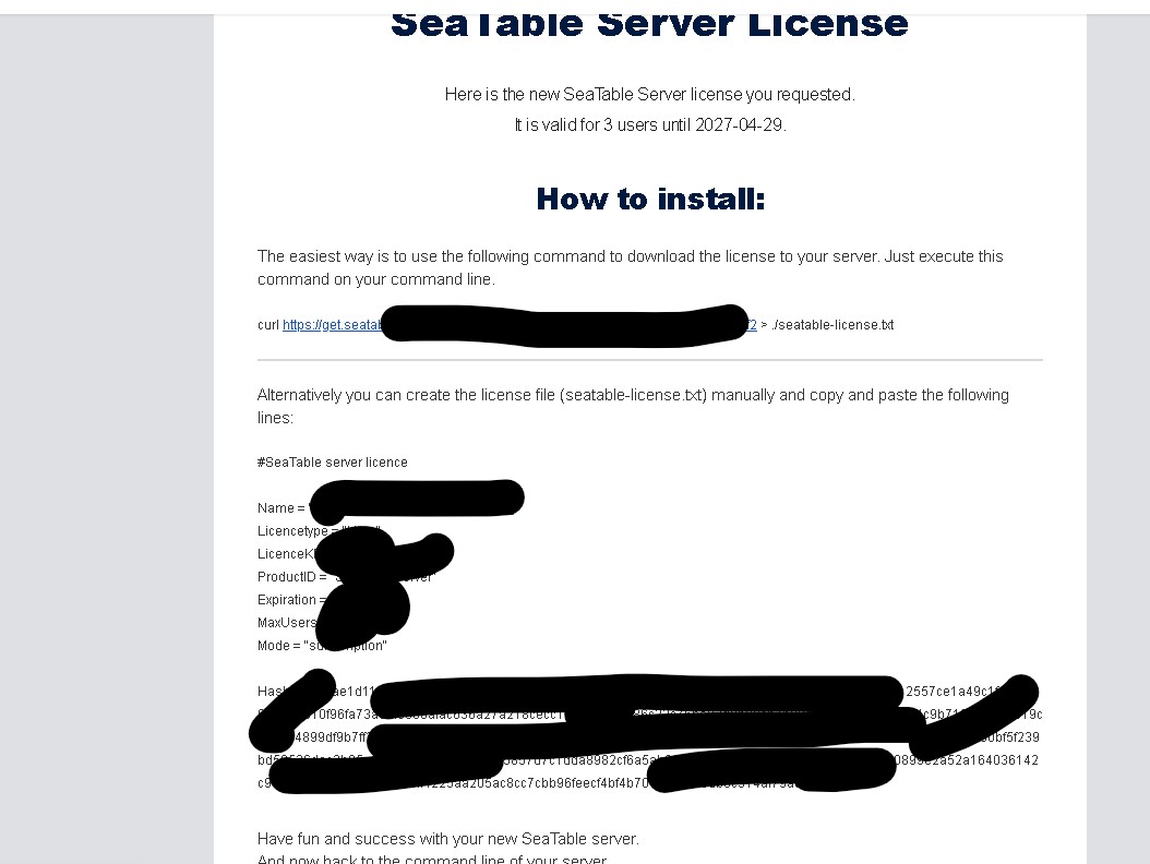

I will send you a new license file via direct message, just in case.
Thank you very much for the license.

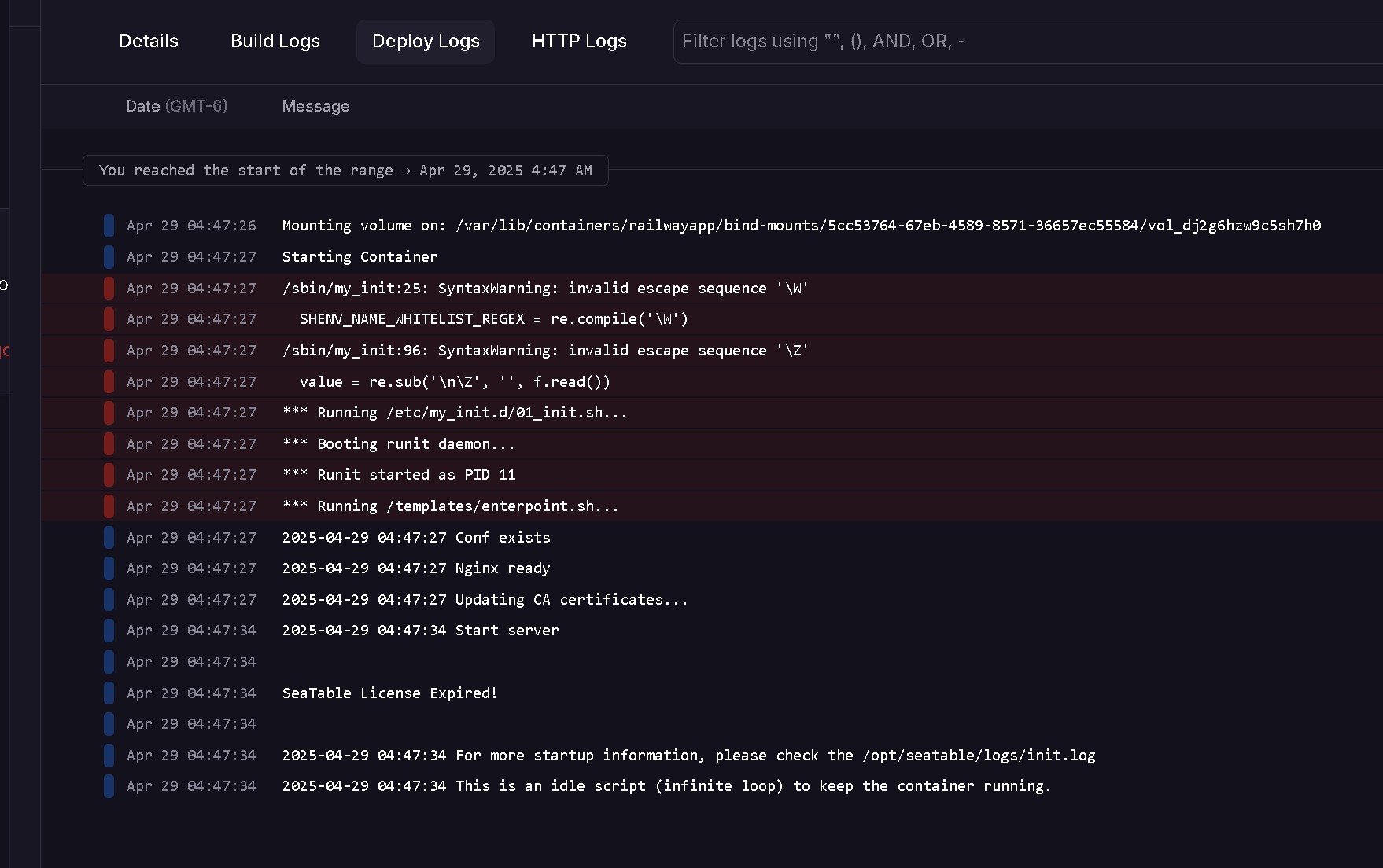

I still get the same error when I’ve tried these image paths:
from Seatable Enterprise
este es el Log:
Mounting volume on: /var/lib/containers/railwayapp/bind-mounts/5cc53764-67eb-4589-8571-36657ec55584/vol_dj2g6hzw9c5sh7h0
Starting Container
2025-04-29 04:47:27 Conf exists
2025-04-29 04:47:27 Nginx ready
2025-04-29 04:47:27 Updating CA certificates…
2025-04-29 04:47:34 Start server
2025-04-29 04:47:34 For more startup information, please check the /opt/seatable/logs/init.log
2025-04-29 04:47:34 This is an idle script (infinite loop) to keep the container running.
But with the Seatable Enterprise image,
It seems the license error no longer appears.
So, I don’t know if it won’t be possible to update in the future.

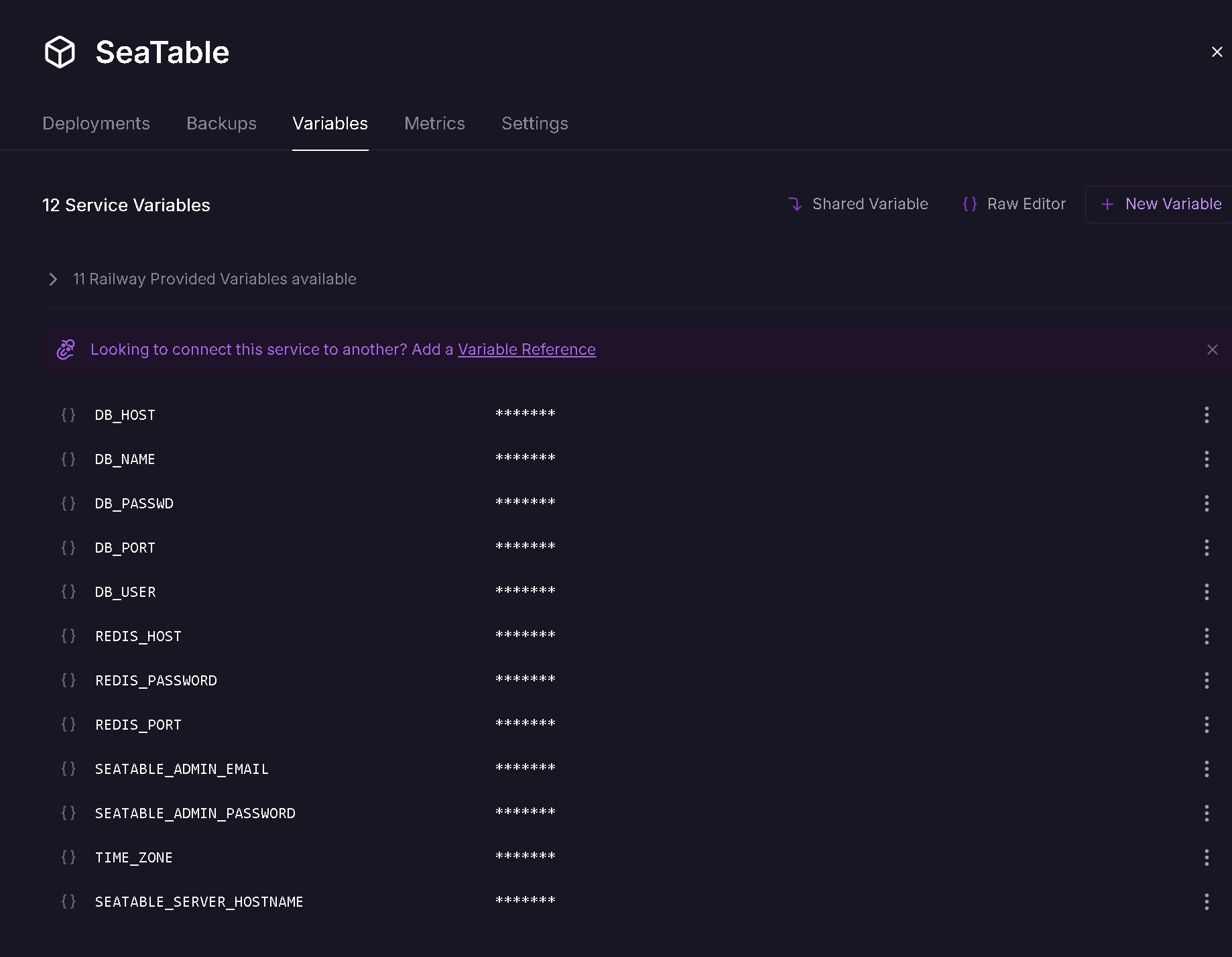

I corrected a variable in MySQL:
MYSQL_ROOT_PASSWORD=“${{MySQL.MYSQLPASSWORD}}”
DB_ROOT_PASSWD=“${{MySQL.MYSQLPASSWORD}}”
I’m keeping both for now,
With this version, which doesn’t indicate a license error,
I still get errors.
Thank you in advance for the attention and the great support you’re giving me.
Subject: Re: “do not find /shared path” Failed to install on RAILWAY - Update & Resolved Issues
Hi all,
Updating this thread which originally started with the “do not find /shared path” error during installation on Railway.
  1. /shared Path Issue: This initial problem was resolved. We confirmed that using /shared as the volume mount point is indeed correct for the seatable/seatable-enterprise image in the Railway environment (as opposed to /opt/seatable/seatable-data).
  2. ‘License Expired!’ Issue: We also discussed the subsequent ‘License Expired!’ error within this thread. This issue has also been resolved. The fix involved correcting the Redis environment variable names from REDIS_HOST, REDIS_PORT, REDIS_PASSWORD to the required DTABLE_REDIS_HOST, DTABLE_REDIS_PORT, DTABLE_REDIS_PASSWORD. This allowed SeaTable to connect to Redis properly during startup.
