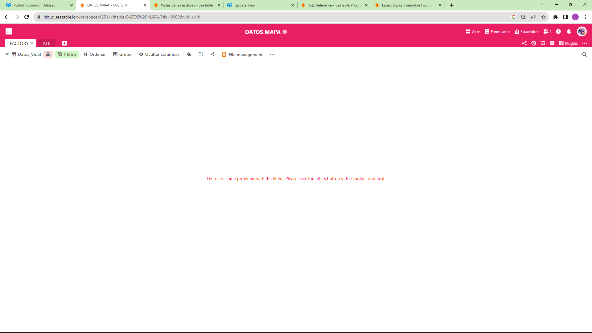

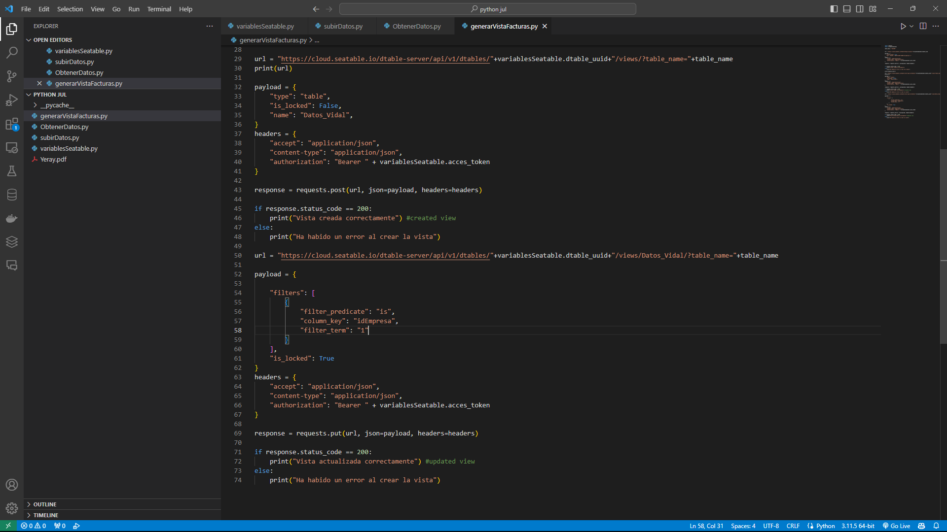

I create a view from a table to then update the filters by idEmpresa, my problem is the code is ok, but when i go to seaTable says there is some error in the filters go ther and fixed it.
I assume there is a mistake in your code.
Please use https://api.seatable.io to create the code and copy-paste that over. Then retry running your script.
Done! The error was i understand bad the column_key, i was putting the name of the column instead the key asociated to that column… my bad jejejeje. That key apear in the metadata! XoX
