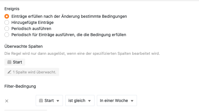

I set up an email reminder to warn me of a course start date 1 week prior to the start. When I tested it, it worked fine. I should have received one yesterday, but nothing arrived. Online spam folder checked, etc. See screenshot of settings
Only one email address was entered as the target address.
Perhaps the wrong “Ereignis”-Option, although none of the others seem to fit?
Check the automation log.
There are only 3 success messages, relating to the day I set it up (5 October). It should have sent one yesterday (12 October)
Just a thought: perhaps the reason why it doesn’t work is because the condition is “Records meet specific conditions after modification”
In reality, no modification takes place. All that happens is that a date is reached that was already set in the column.
I did a test where I entered a date, set a rule, then went back and changed the date to another and back again - an email was sent, clearly because the condition of “modification” was met.
The “notifications” rules offer the opportunity for “near the deadline” but there is no option to send an email (except the general setting for sending notification emails when somethin is changed, which here isn’t the case).
You are right with your assumption: the trigger you defined only watches for “changes”.
Therefore:
Change it to “Periodisch für Einträge ausführen, die die Bedingung erfüllen”.
The condition could be “date - is equal - in one week”.

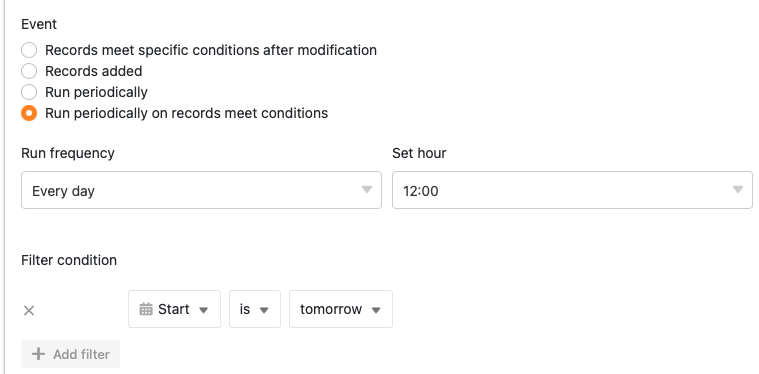

Hi, I did another test using the settings as requested. Nothing has been sent.
Here are the settings
Your filter condition is different from your other posts (“Tomorrow” vs. “In a week from now”). Is this the cause?
This is another test so I don’t have to wait too long.![]()
