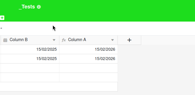

I think you don’t have to specify something in the else part, for example the formula if(not(isempty("Column B")),dateAdd({Column B},12,"months")) worked when I tried it: it calculates the date if Column B is not empty and displays nothing if Column B is empty (but the column is still considered having a date format).

Thank you @bha. Unfortunately the type changes to string instead of date, which leads to a non european date format and things like date rules for color columns don´t work anymore.
Hi again,
Are you sure you use the same formula? In mine, there is nothing like the “” you mentioned (the if formula should look like if(logical, value1, value2) but I just defined if(logical, value1) but nothing happens when the condition is false), and as I said in my last message, the detected format remains european/date.
date_format

@Max1411 , to bring the example of @bha and yours together, please make a screenshot of the top of your date and formula columns from an unsorted and unfiltered view.
Background: I have the suspicion that while the very first date values in “Column B” in the example of @bha contain a date (in fact, the top one), yours doesn’t. The format detection runs on the very first value of a column. If that is empty (no else clause in the if()), then it runs into #!VALUE, or string (else “”), or an undefined state.
