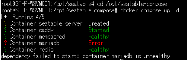

I tried to change to the new installation method as described in this web page and had no problems up to step 7, the last step gave me this error:
Switch Installation Method (v4.3) - SeaTable Admin Manual
Hey yGuo,
we added a healthcheck to the mariadb container, that does some check at startup. This healthcheck requires a specific mariadb-user to execute these checks. This user was added with mariadb mid of 2023. So it seems that you started with a SeaTable version which recommended an older mariadb version and now after the upgrade to the current mariadb this healthcheck user is not there.
So much for explanation. There are two ways forward:

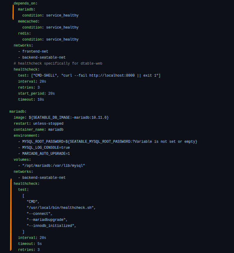

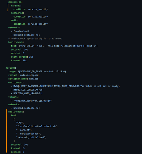

You can fix this immediately by just open your /opt/seatable-compose/seatable-server.yml file and comment these lines I marked in orange:
It should look like this. Make sure that you keep the indentations because otherwise docker compose up -d will not work anymore.

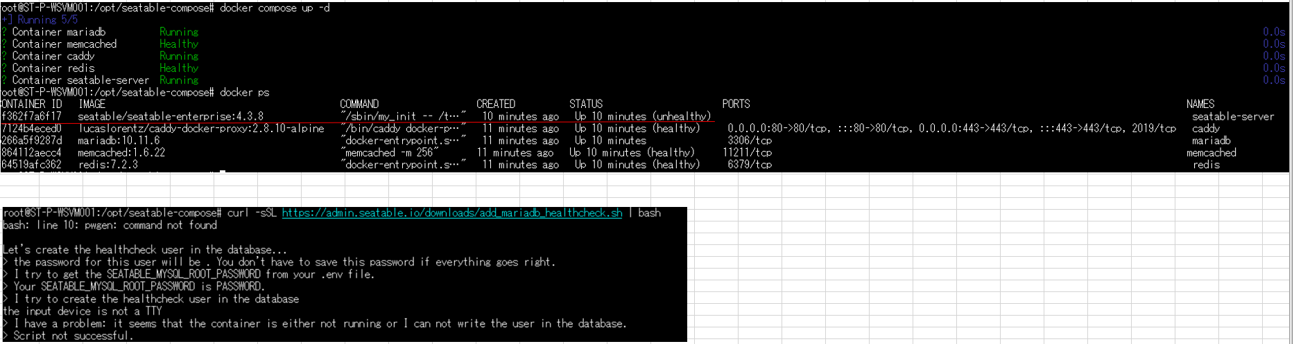

Following the method A) Quick Fix, the error with mariadb unhealthy no longer occurs, but the seatable-server remains unhealthy.
Next, I tried method B, unfortunately, it didn’t run successfully. There may be other issues with our server.
Thank you again, and I look forward to your response.
Additionally, I would like to inquire if there is a way to revert our SeaTable server back to v4.2 and have it running normally.
A) the Container can not be unhealthy if you disabled the health checks. Please check.
B) From your screenshot, I can tell you that pwgen is not installed. I added more checks in the script. You can install pwgen with apt install pwgen and then run the script again.
