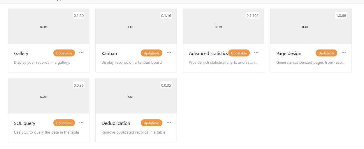

I recently upgraded to Seatable 3.0.16 EE, doing all the necessary extra steps in the documentation. However, today i went to update my plugins and this is what appeared:
When clicking on the button to upgrade, an error notification pops up.

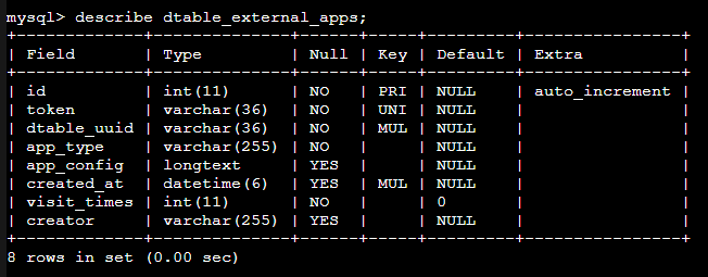

I was pretty sure i did the migration, but after running that describe command it seems that in fact the migration did not occur. However, as i tried running the commends again, i would either get no output (and no migration or some errors).
Is there any way to check the version of the current database?
Edit:
I actually managed to successfully migrate and the output of the describe command is now looking like you said it should:
However, i still get the same issue with the plugins and external apps.
Edit2:
After looking at logs again after upgrading the database, i saw something about the plugin repo and checked the dtable_web_settings.py . Apparently i had second PLUGINS_REPO_ID varible with a different value that was messing things up - i deleted the new one which must have gotten there during this last 3.0 update when i added things to that config and plugins are working perfectly now.
So to summarize:
  • Upgrading the database properly fixed the external apps issue
  • A second PLUGINS_REPO_ID with a wrong value was causing the plugins to not be updatable
