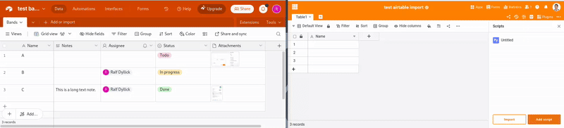

@rdb Am I doing anything wrong or is it an internal error ?
I guess you are doing something wrong.
Bildschirmaufzeichnungvom2025-05-0211-59-12-ezgif.com-video-to-gif-converter
Voilà the script I used. (I didn’t specify the API token explicity, but used the context object.)
