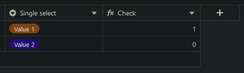

Hi Michael.
The reason you get that “Unexpected char” error is, because you are using the wrong quotion marks.
Try these formulars:
if({Single select} = "Value 1", 1, 0)
or
if({Single select} = 'Value 1', 1, 0)
grafik
Greetings
AkDk7
