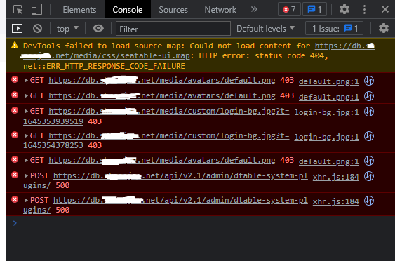

Hello, I’ve deployed seatable developer version on a Synology to evaluate the dbms. I’ve configured the stack using docker-compose and used this guide to manually reconfigure the values in ccnet.conf and dtable_web_settings.py as I’ll be using SSL certs deployed by Synology’s built-in nginx reverse proxy. Using these settings I was successfully able to access seatable instance via https, create and play around bases.

Issue
Everything works perfectly except the plugins, avatars and some CSS errors. Upon inspecting the console on various pages I could observe the following:
  1. Manual upload or direct market install of plugins fail : POST https://db.example.net/api/v2.1/admin/dtable-system-plugins/ Error 500
    Tried redeploying container but issue persists.
  2. Avatars do not load not even manually uploaded avatars: GET https://db.example.com/media/avatars/default.png 403
  3. Even login background fails to show: GET https://db.example.com/media/custom/login-bg.jpg?t=1645353939519 Error 403
  4. Then there are some CSS related errors:
    https://db.example.com/media/css/seatable-ui.map Error 404
    https://db.example.com/media/css/antd-mobile.min.css.map Error 404
Here are some logs:
dtable_web.log
2022-02-20 10:53:05,446 [ERROR] django.request:230 log_response Internal Server Error: /api/v2.1/admin/dtable-system-plugins/

pysearpc.common.SearpcError: Invalid repo id

2022/02/20 16:05:45 [error] 42#42: *377 open() "/opt/seatable/seatable-server-latest/dtable-web/media/css/seatable-ui.map" failed (2: No such file or directory), client: 192.168.128.1, server: db.example.com, request: "GET /media/css/seatable-ui.map HTTP/1.1", host: "db.example.com"
2022/02/20 16:05:45 [error] 41#41: *378 open() "/opt/seatable/seatable-server-latest/dtable-web/media/css/antd-mobile.min.css.map" failed (2: No such file or directory), client: 192.168.128.1, server: db.example.com, request: "GET /media/css/antd-mobile.min.css.map HTTP/1.1", host: "db.example.com"
2022/02/20 16:05:45 [error] 43#43: *390 open() "/opt/seatable/seatable-server-latest/dtable-web/media/avatars/default.png" failed (13: Permission denied), client: 192.168.128.1, server: db.example.com, request: "GET /media/avatars/default.png HTTP/1.1", host: "db.example.com", referrer: "https://db.example.com/"
2022/02/20 16:09:53 [error] 42#42: *401 open() "/opt/seatable/seatable-server-latest/dtable-web/media/css/seatable-ui.map" failed (2: No such file or directory), client: 192.168.128.1, server: db.example.com, request: "GET /media/css/seatable-ui.map HTTP/1.1", host: "db.example.com"
2022/02/20 16:09:54 [error] 42#42: *402 open() "/opt/seatable/seatable-server-latest/dtable-web/media/avatars/default.png" failed (13: Permission denied), client: 192.168.128.1, server: db.example.com, request: "GET /media/avatars/default.png HTTP/1.1", host: "db.example.com", referrer: "https://db.example.com/sys/info/"
2022/02/20 16:09:55 [error] 42#42: *408 open() "/opt/seatable/seatable-server-latest/dtable-web/media/avatars/default.png" failed (13: Permission denied), client: 192.168.128.1, server: db.example.com, request: "GET /media/avatars/default.png HTTP/1.1", host: "db.example.com", referrer: "https://db.example.com/sys/users/"
2022/02/20 16:09:57 [error] 42#42: *411 open() "/opt/seatable/seatable-server-latest/dtable-web/media/avatars/default.png" failed (13: Permission denied), client: 192.168.128.1, server: db.example.com, request: "GET /media/avatars/default.png HTTP/1.1", host: "db.example.com", referrer: "https://db.example.com/sys/web-settings/"
2022/02/20 16:09:58 [error] 42#42: *415 open() "/opt/seatable/seatable-server-latest/dtable-web/media/custom/login-bg.jpg" failed (13: Permission denied), client: 192.168.128.1, server: db.example.com, request: "GET /media/custom/login-bg.jpg?t=1645353598337 HTTP/1.1", host: "db.example.com", referrer: "https://db.example.com/sys/web-settings/"
2022/02/20 16:14:21 [error] 43#43: *419 open() "/opt/seatable/seatable-server-latest/dtable-web/media/css/antd-mobile.min.css.map" failed (2: No such file or directory), client: 192.168.128.1, server: db.example.com, request: "GET /media/css/antd-mobile.min.css.map HTTP/1.1", host: "db.example.com"
2022/02/20 16:14:21 [error] 42#42: *420 open() "/opt/seatable/seatable-server-latest/dtable-web/media/css/seatable-ui.map" failed (2: No such file or directory), client: 192.168.128.1, server: db.example.com, request: "GET /media/css/seatable-ui.map HTTP/1.1", host: "db.example.com"
2022/02/20 16:14:21 [error] 43#43: *425 open() "/opt/seatable/seatable-server-latest/dtable-web/media/avatars/default.png" failed (13: Permission denied), client: 192.168.128.1, server: db.example.com, request: "GET /media/avatars/default.png HTTP/1.1", host: "db.example.com", referrer: "https://db.example.com/"
2022/02/20 16:15:36 [error] 42#42: *440 open() "/opt/seatable/seatable-server-latest/dtable-web/media/css/seatable-ui.map" failed (2: No such file or directory), client: 192.168.128.1, server: db.example.com, request: "GET /media/css/seatable-ui.map HTTP/1.1", host: "db.example.com"
2022/02/20 16:15:37 [error] 44#44: *448 open() "/opt/seatable/seatable-server-latest/dtable-web/media/avatars/default.png" failed (13: Permission denied), client: 192.168.128.1, server: db.example.com, request: "GET /media/avatars/default.png HTTP/1.1", host: "db.example.com", referrer: "https://db.example.com/sys/info/"
2022/02/20 16:15:38 [error] 42#42: *449 open() "/opt/seatable/seatable-server-latest/dtable-web/media/avatars/default.png" failed (13: Permission denied), client: 192.168.128.1, server: db.example.com, request: "GET /media/avatars/default.png HTTP/1.1", host: "db.example.com", referrer: "https://db.example.com/sys/web-settings/"
2022/02/20 16:15:39 [error] 44#44: *452 open() "/opt/seatable/seatable-server-latest/dtable-web/media/custom/login-bg.jpg" failed (13: Permission denied), client: 192.168.128.1, server: db.example.com, request: "GET /media/custom/login-bg.jpg?t=1645353939519 HTTP/1.1", host: "db.example.com", referrer: "https://db.example.com/sys/web-settings/"
2022/02/20 16:22:58 [error] 42#42: *454 open() "/opt/seatable/seatable-server-latest/dtable-web/media/custom/login-bg.jpg" failed (13: Permission denied), client: 192.168.128.1, server: db.example.com, request: "GET /media/custom/login-bg.jpg?t=1645354378253 HTTP/1.1", host: "db.example.com", referrer: "https://db.example.com/sys/plugins/"
2022/02/20 16:22:58 [error] 42#42: *458 open() "/opt/seatable/seatable-server-latest/dtable-web/media/avatars/default.png" failed (13: Permission denied), client: 192.168.128.1, server: db.example.com, request: "GET /media/avatars/default.png HTTP/1.1", host: "db.example.com", referrer: "https://db.example.com/sys/plugins/"```
How should I go about resolving this so I can evaluate seatable properly?
I am the author (of the German original) of the linked article. I successfully tested the tutorial only a few weeks ago - with SeaTable Enterprise Edition, though, but should not make a difference.
I have no experience with Docker on Synology. But I seem to remember that there are restrictions.
The repo id in dtable_web_settings.py is generated on first startup. Because you did not post your config files here, it’s difficult to say what the problem is.
As for nginx’s error.log: No wonder your CSS, avatars, and images are not loaded correctly. If the permission is denied, they cannot be loaded. Unfortunately, I don’t know the cause of the permission problem. I have never seen this issue beforehand. Can you manually change the permission and see if that solves your problem?

I would like to draw your attention to some facts below:
  1. Adding an ‘s’ after http for DTABLE_DB_URL in dtable_web_settings.py results in a permission/callback error when creating an admin user. Even though it wasn’t mentioned in the blog post, I tried just in case.
  2. I’m using Cloudflare proxy and Cloudflare Origin SSL to access db outside my main network, But this should not be an issue, as the same problem occurs when accessing certain seatable assets from inside the local network
  3. ‘root’ owns the persistent volumes for the seatable stack and has complete control over all files and folders.
Any pointers are highly appreciated. Thanks!
This is probably the problem.
This post may help you: https://forum2.seatable.io/t/error-when-uploading-plugins-self-hosted/378/8?u=rdb
Well, going out for a water break worked! I can now install plugins.
However, 403s, when accessing avatars and background, remains a mystery.
Your nginx.log reports missing files/directories and permission denied errors. Check if the files are really missing. Check the permissions, set them to 777 to rule out a constraint on that frton.
Did you solve your problem?
