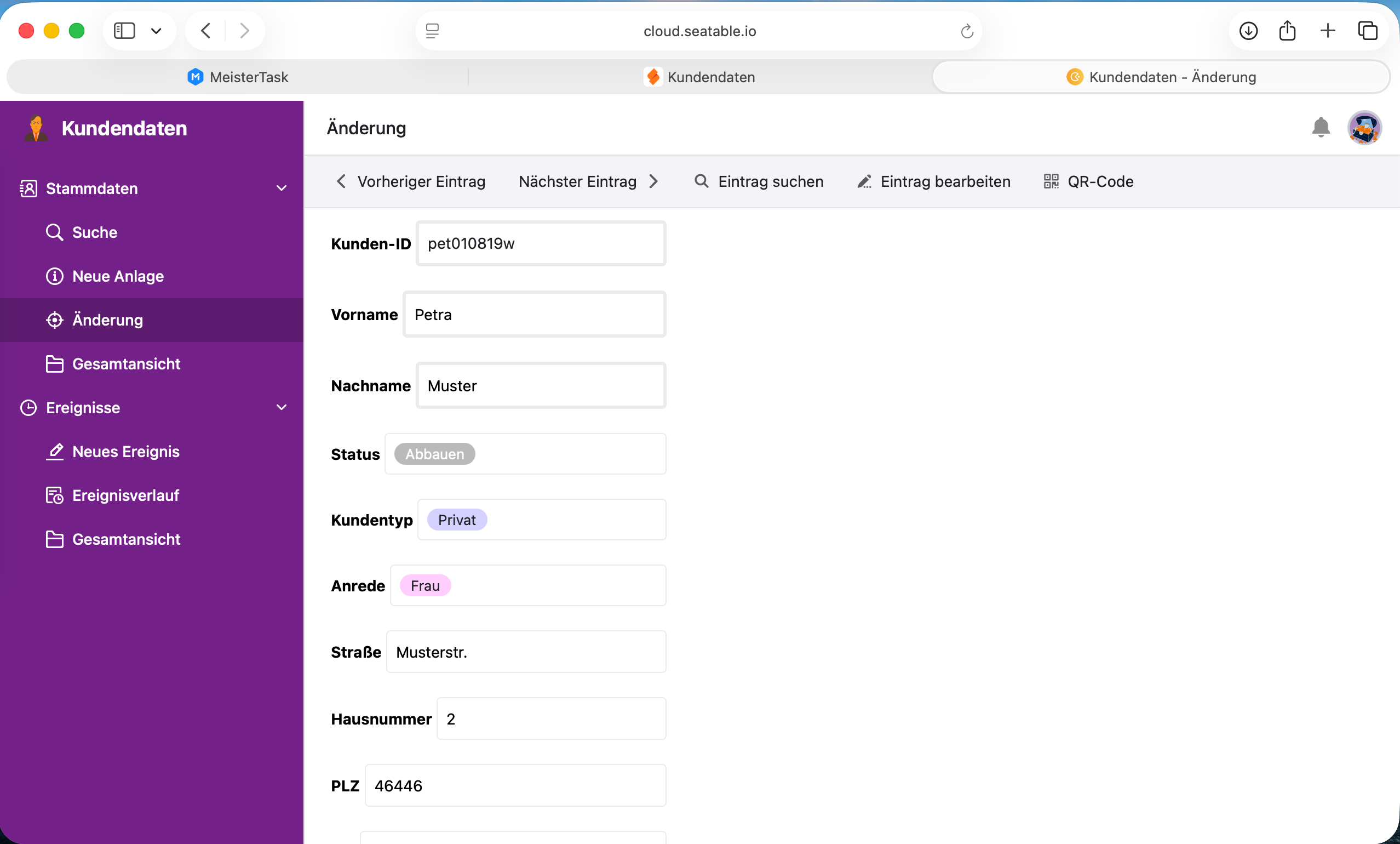

Attached are two screenshots of the input screen I’m referring to.
<<<ONE attached: “An error occurred: Sorry, new users can only put one embedded media item in a post.”>>>
See here: Edit entry (Eintrag bearbeiten)
There is no submit button at the bottom; instead, every change to a field is immediately sent to Make (via webhook).
It would be very helpful if there were a submit button here as well.

Yes, I am talking specifically about forms. The idea of ​​the new column as a checkbox, which would then trigger make.com, is probably already possible in principle, but the rationale is still vague. Because when you first create a form, there’s also a submit button and the field entries aren’t immediately written to the database individually — as would otherwise be the case if you were writing directly to the database (without a form).
And the form for edits/changes behaves unexpectedly differently than the form for the initial creation. :thinking:
If this isn’t intentional, I haven’t overlooked anything nor accidentally configured something incorrectly in the app.
