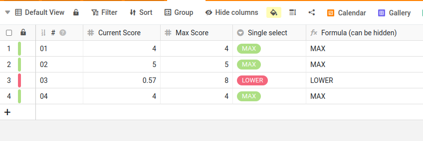

Color (Use rules) can not compare different columns. Therefore, I don’t see an easy solution, to show the value and use the coloring at the same time. As soon as you print also the lower numbers, the criteria for the color is gone.
I see the alternative, that you use a single select column and then color the row based on this single select column. The value of the single select column is set by an automation every time a number is entered. The automation watches the formula and sets the single select column.

I’ll use this workaround for now, it’s not a big issue luckily
