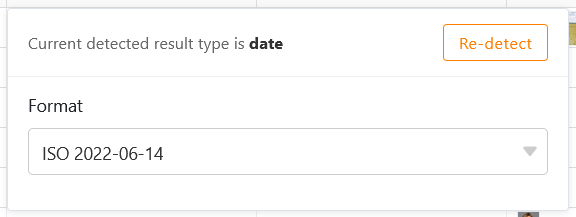

For 2.) The formula column knows four result types: string, date, number, and array. When you create a formula column, SeaTable analyses the content of the cells and then decides on the result type. Once assigned, the result type is static. It does not change even when you change the formula. If you want it to change, you must force a redetection of the result type. You can do this in the “format settings” menu:

Thank you for your help! I will supplement it… On question 2, it was like this: the first (upper) values with the date were empty, when I put the date in the first cell, seattable allowed me to change the format. I have version 2.7, maybe in the new version it works as it should. Thanks!
