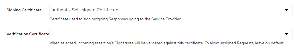

However, I have a tiny problem with the signing of messages from Seatable towards my IDP (Authentik), but not the other way round. When I set up Authentik not requiring signatures for requests from Seatable, SSO works. However, Seatable writes into its logs that it’s unsafe to use an IDP which does not require signed communication.
However, when I force Authentik to verify requests from seatable to be signed with seatable’s certificate, which I have created according to the manual page, this is what happens:
Seatable does not seem to sign its messages!
How do I make seatable actually sign outgoing messages?
