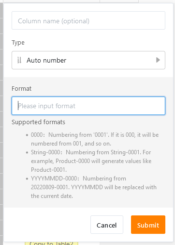

Have you tried the auto number column type?
Based on your description, this could work:
  • Add an extra auto number column to your table
  • Modify the concatenation formula in your formula column
  • Check if this works
