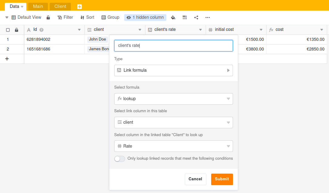

Hi @platerytter , and welcome on the SeaTable forum. As far as I understand your problem, here is how I think it could work :
  • you have one “Clients” table containing a “rate” column
  • you have one “Data” table with several column, and particularly :
    1. one “client” column (of type link to other record, linked to your “Clients” table)
    2. one “client’s rate” column (of type link formula / lookup, see bellow) to get the client’s rate in your “Data” table
    3. Probably an “initial cost” column : the cost before applying the rate
    4. Finally, a “cost” or “final cost” column, obtained by multiplying the initial cost by the client’s rate
  • a “Main” table, with the following columns:
    1. A column of type link to other records that will link each row with the rows of the “Data table” you wish to consider (let’s call it “data”)
    2. A column of type link formula with the desired rollup function (see bellow)
To make it short, even if the structure is not exactly what you need (one again, sorry if I misunderstood your case):
  • you have to create links between tables before being able to get data from another table, or being able to summarize values like sum, min/max or average
  • do not hesitate to browse the links above from the SeaTable help about links
Hope that helps,
