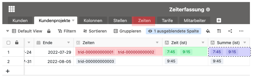

Hi you SeaTablers,
I have the following problem. I do a lookup on the times table and get individual records (marked in red). I let the times be displayed (green). How can I summarize the individual times to a total (blue)?
Thanks for your help Yaenz
Please use a roll-up function in the link formula column. Summary method should be sum.

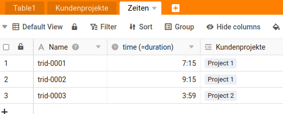

Hey Yaenz,
here is how I would do this:
  1. save the time in a duration column and not a text or value column !!!
  1. then use the link formular with the rollup to summarize the time.
  1. with this setup you get this result.
  1. Probably you have to change the format of the column
Best regards
Christoph
Ohhhh Christoph,
Thanks a lot, this finally works fine.
