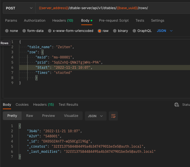

Hello you SeaTablers, I need your swarm intelligence again. I’m building a tool to record working hours. But to start a record I also need the project and the employee. I am trying to use HTTP POST as per the Postman documentation.
But the fields arrive empty. (blue)
Bildschirmfoto 2022-11-21 um 10.11.26
I tried it as a real name but also via the row-id of the projects or employees table. How do I make this key for the binding to other tables?

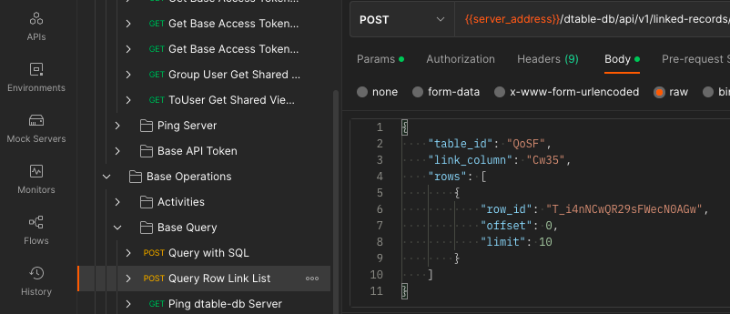

Anything HTTP is available to me. But I took your approach and searched the SeaTable API documentation and found the following. Is this what you mean?

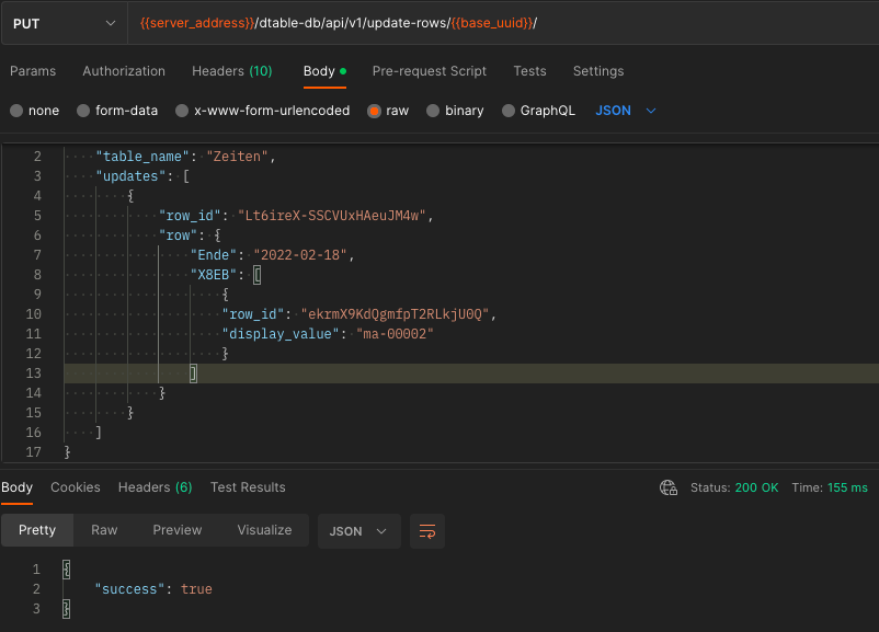

I can update some date stuff but not the linked values.

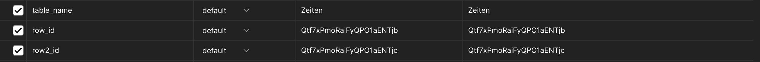

But it looks the same when I make a SQL request like
where do I have the mental error here in my mind?

That seems to return a list with all link typed columns in a table and this is one part of the show you need.
In the api reference I found this: Introduction
It shows you the data which is needed to update an existing row with a linked record.

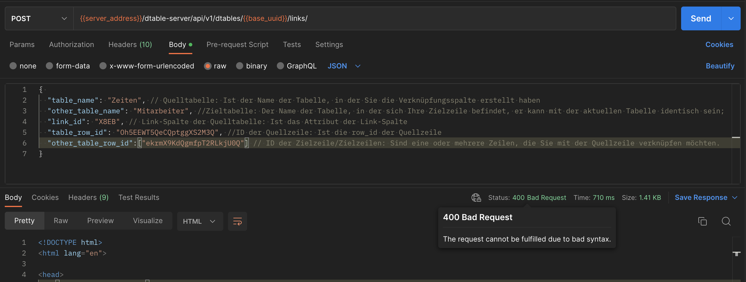

Complete desperation spreads. AkDk7’s idea was absolutely correct, but the implementation is completely inexplicable to me. Here is the API documentation Introduction
The starting point:
But ist not working at all. Looking for some help.
Tanks so much
Hi @cahore.

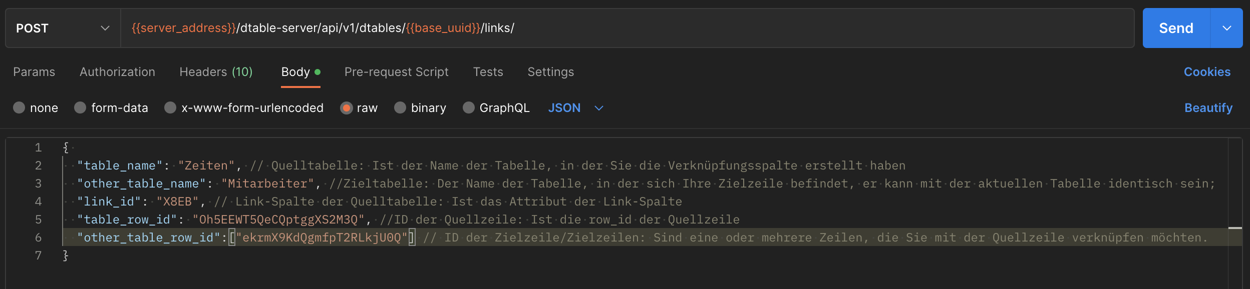

The value for “other_table_row_id” has to be an array even if it is only one link. Just put it in like this: “other_table_row_id”: [ “…” ]
ahhhh thanks … I did it like this
Am I right when I say:
You wanted to say: Seems to work? :slight_smile:
Not yet, but it feels so close. 400 Bad requests as you can see.
Ah, I might be wrong. Have a look into the api reference again. There they say it has to be in curly braces like: "other_table_row_id": "{{row_id_table2}}"
