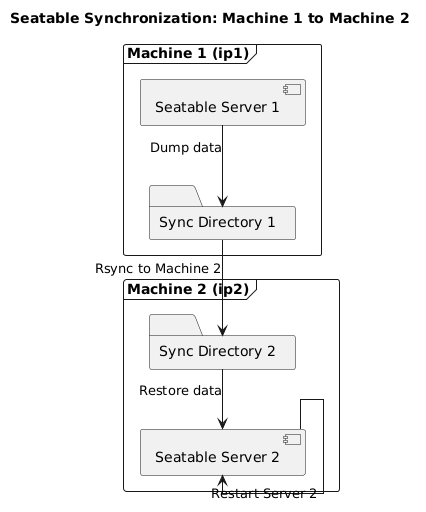

Thank you for these pointers. After some trial and error I think I found a working solution. Please find attached two scripts for anybody with a similar issue to start from. The first script seatable-push-sync.sh pushes from one server to its duplicate, using a local directory “seatable-sync” that is synced between both servers either way on each machine.
Once the synchronization is pushed from machine 1 to machine 2, on machine 2, I execute seatable-restore-sync.sh which loads the new data into seatable.
I noticed that this is not sufficient, because seatable keeps data in memory, so to be sure to have a clean situation on machine 2, I do immediately after the restore sync the following:
sudo docker compose down
sudo docker-compose up -d
The whole process is shown below, in both directions:
This seems to work fine as process. I have/had a few minor issues:
  • I wanted to use --ignore-table suggested by the documentation to save unnecessary syncronization, but it doesn’t work (haven’t followed up)
  • I had issues because there are different urls/IPs (that is mentioned in the documentation) but also ports that need to be specified. In particular this needs to be edited in seatable/conf/dtable_web_settings.py, and when this was included in the sync it messed things up. So I just delete this file, because locally on each server the settings are correct
  • I followed the instructions for adjusting the URLs, but it was unclear what the proper syntax is if one needs to specify ports. See the last line of the restore script. It seems to work, but this could also be because my tables are pretty simple so far (no files, images, which I think are most affected by URLs). In particular I wondered whether the <ip>:<port> needs to be quoted or not for instance
I hope you may find this useful.
