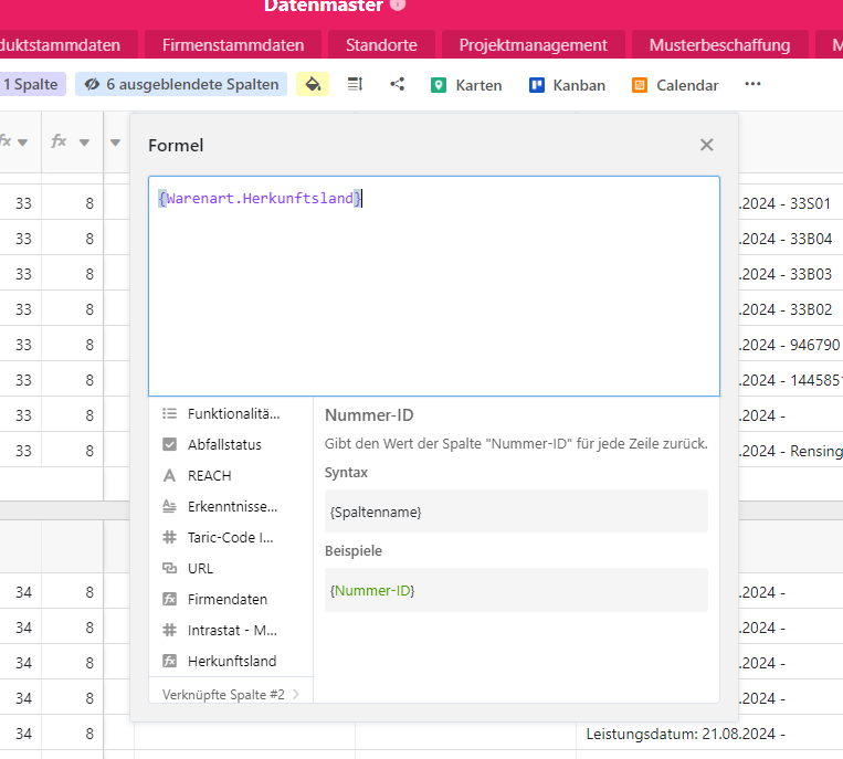

I am trying an easy if-formula quite similar to the example form the seatable website:
if({Warenart.Herkunftsland}=“Deutschland”, “EU”,“DE”)
But I always get an error with inconsistent data. Happy to hear where I get it wrong and how to get it work.

Hi @OAMmer and welcome on the SeaTable forum !
While trying to reproduce your problem, I can’t create a column with a dot inside the name ![]()
Is your column named Warenart.Herkunftsland or maybe Warenart is your table’s name and Herkunftsland your column name ? Can you give us more information about that (just a screenshot of your table’s columns should be enough for the beginning) ?
Bests,
Benjamin
Ok, thanks for the precision, I didn’t know that this syntax was possible !
Considering that, {Warenart.Herkunftsland} is not considered as a text (if you make a column with this simple formula, you’ll see that the result looks like a linked record).
To cast {Warenart.Herkunftsland} to string, you can simply add & "" after, which with force to string type as it concatenates {Warenart.Herkunftsland} with an empty string.
So if({Warenart.Herkunftsland} & ""="Deutschland", "EU","DE") should be fine (but are you sure it’s not if({Warenart.Herkunftsland} & ""="Deutschland","DE","EU") instead ?)
Bests,
Benjamin
The simple formula {Warenart.Herkunftsland} is returing the Herkunftsland correctly from the linked table . That is why I was of the opinion that is considered as text which I can match.
But anyway, that was the solution. Now it is working. Thanks a lot.
