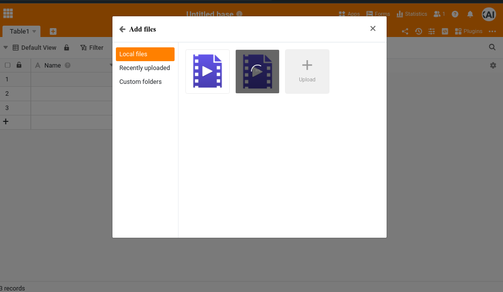

Here’s my trying it again showing a smaller file upload vs larger .mp4 file: https://zipline.kaiyerlab.com/u/hvbFXT.webm
When I try to upload a smaller file (e.g. a gif) it will upload fine. But a larger video file doesn’t upload, and no error no notice is shown either.
Error Messages:
No actual error messages show as you can see in the link provided of the screen recording. Also the console shows no errors either, it seems to just not understand the mp4 upload at all.
So update on this issue: Smaller videos will load.
Larger videos like 2GB + will not.
Edit: testing to see where it’s cutting off. I’ll try a 1GB video next.

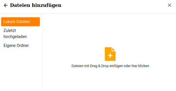

The Analysis
In the default setup/configuration of SeaTable 5.2.7, there is no limitation in the upload file size by nginx, caddy or any SeaTable component.
The problem is the upload window, that SeaTable provides. It seems that this window is not capable to deal with files bigger than 1.5 GB.

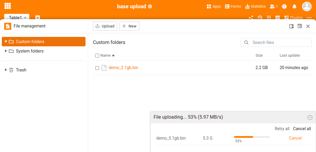

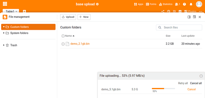

The Workaround

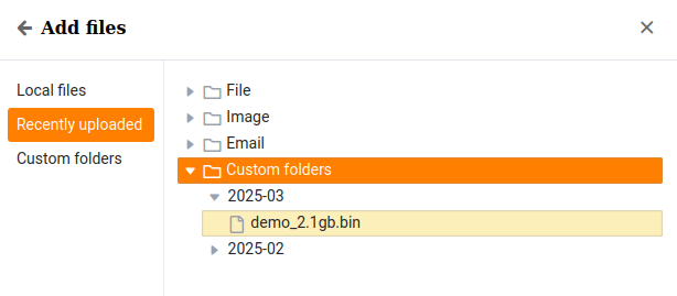

But there is a workaround. Instead of using the upload window of the file column, you can upload a file via the “file mgmt”.
After the file is uploaded, you can assign the file to the file column.
I successful tested this approach with a 2.1 GB and 5 GB file.
