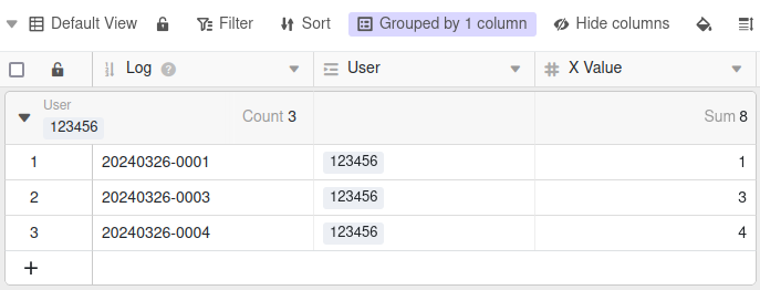

If you just want to know the result but don’t want to store it (which I doubt, but who knows ??), you can simply group your view by ID, and you’ll get the value in the summary header of the group (see bellow)
Here is a grouped view of my Logs table with three columns : the Log column to identify the log, the User column containing the user’s id (it’s a linked column, but we will see that in the second part) and the X Value column (the data you want to sum)
As you can see, the header of the group for user 123456 displays a sum of 8 : 1 (first log) + 3 (second log) + 4 (third log). By the way, you can select which summarized info you want to display sum, min, max, average, etc.

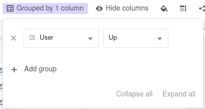

And here is the setting of my grouping :

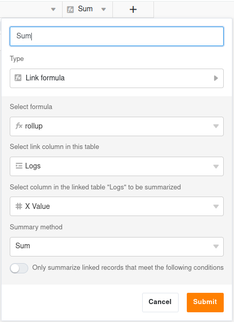

Once you created this link, you will be able to create your sum in the Users table, using a Link formula/Rollup column type :

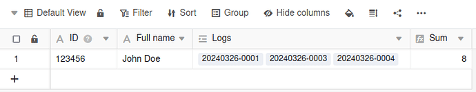

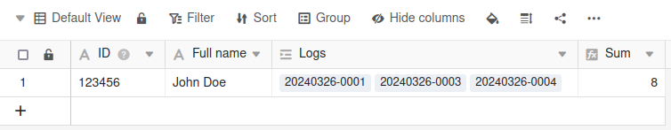

and here is the result :
