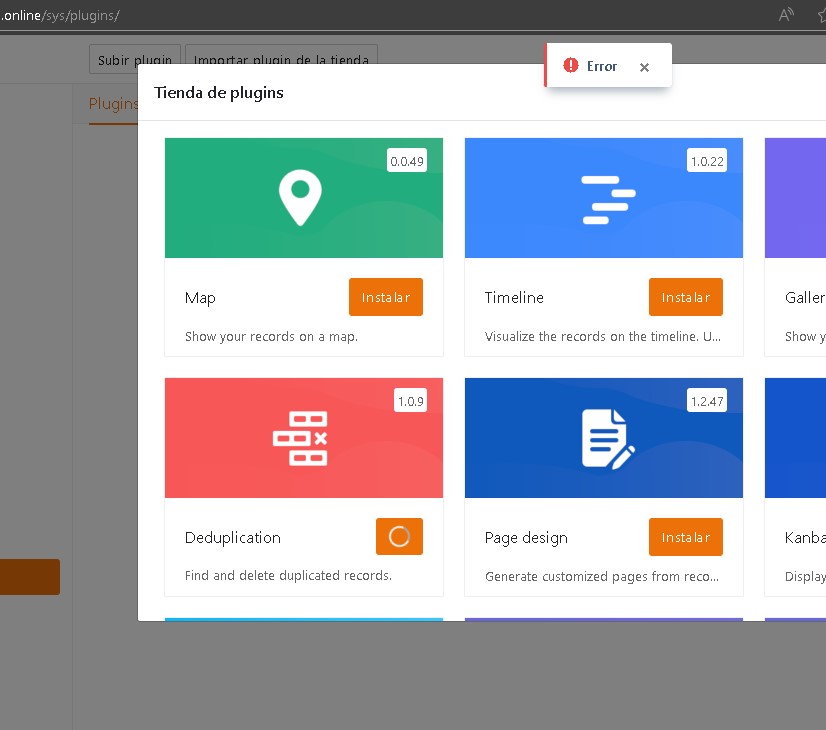

Failure when Installing Plugins from the Marketplace:
I can see the “Plugin Marketplace” and the full catalog of official plugins (see image_b7e57b.png). But, when I click “Install” for any plugin, the operation fails, and the UI displays a generic “Error” popup.

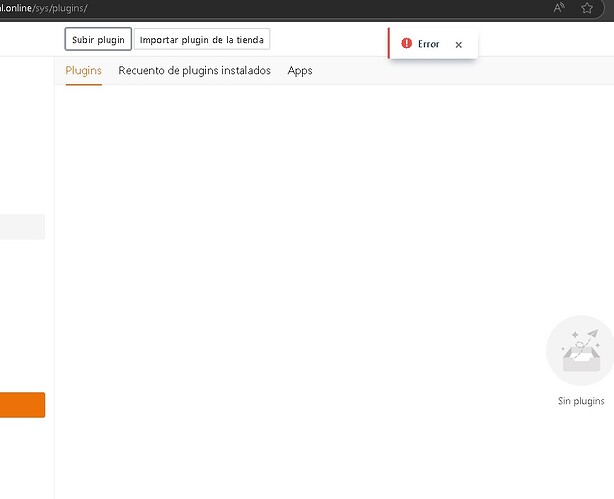

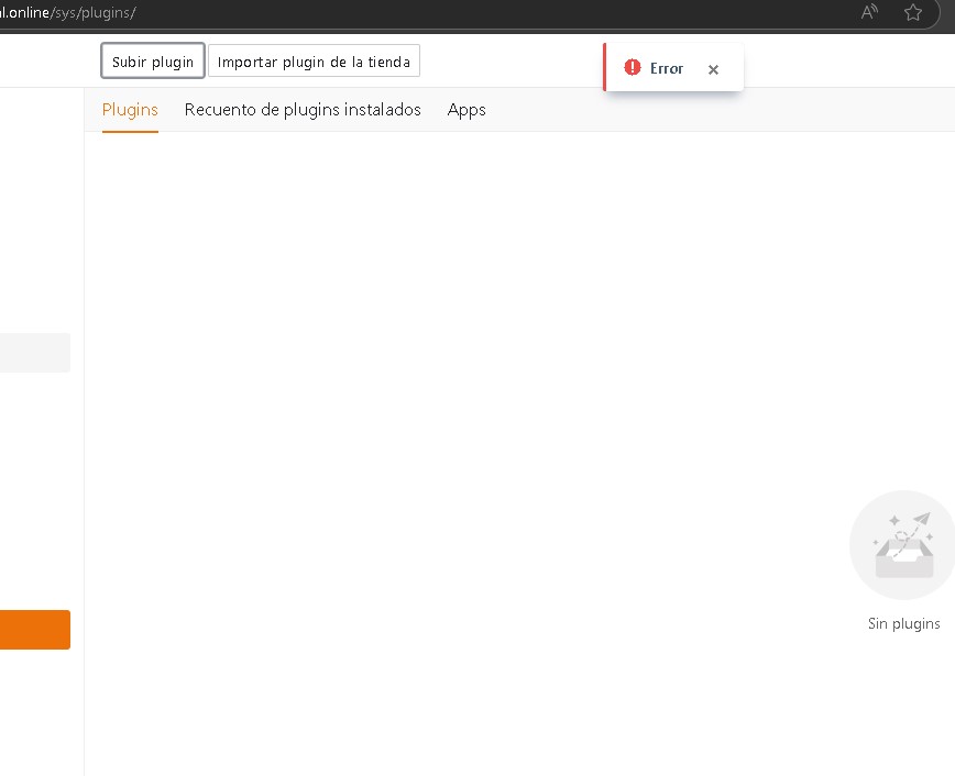

Failure when Uploading Plugins Manually:
If I try to use the “Upload plugin” option from System Admin → Plugins, this operation also results in an “Error” (see subir plugins.jpg).

There are no requirements to install SeaTable Plugins. SeaTable just downloads a list of available plugins from here https://market.seatable.io/api/plugins/.
If you want to install a plugin, it just downloads a zip file and that’s it.

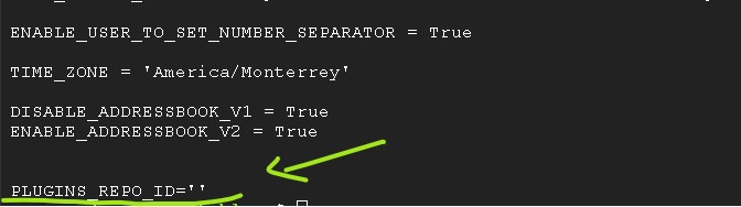

When I inspect /shared/seatable/conf/dtable_web_settings.py inside the seatable-server container, what should the value of PLUGINS_REPO_ID be for SeaTable Enterprise 5.2.7 if I intend to use the official marketplace (market.seatable.io) and not a self-hosted Seafile library for plugins? If it’s currently PLUGINS_REPO_ID = '' by default, this seems to be causing the “Invalid repo id” error.
Could this also be the reason why manual plugin uploads (to /api/v2.1/admin/plugins/upload/) are failing with a 500 error, even if a different traceback isn’t explicitly logged for that specific URL?
What is the recommended configuration for PLUGINS_REPO_ID in dtable_web_settings.py for this version to correctly use the official plugin marketplace and allow manual uploads?

Remove this complete line with PLUGINS_REPO_ID='' from your dtable_web_settings.py and restart all containers. Don’t just comment the line, remove it.
Thanks for the ongoing discussion. I have an important update on the PLUGINS_REPO_ID issue.
I removed the PLUGINS_REPO_ID = '' line and restarted all containers.
Result:
The line PLUGINS_REPO_ID = '' reappeared in dtable_web_settings.py after the restart.
This confirms that the seatable-server container startup scripts are regenerating this setting with an empty string, likely because SEATABLE_PLUGINS_REPO_ID is not defined in my .env file.
Consequently, the error pysearpc.common.SearpcError: Invalid repo id for POST /api/v2.1/admin/dtable-system-plugins/ (when trying to install from the store) persists in dtable_web.log.
Manually uploading the plugin (to POST /api/v2.1/admin/plugins/upload/) continues to fail with a 500 error in the browser,
with no specific trace logged in dtable_web.log for this specific upload URL (the only Python error logged is “Invalid repository ID” for /dtable-system-plugins/).

This is from the script that is executed on each start. SeaTable checks, if PLUGINS_REPO_ID exists in dtable_web_settings.py. If not, it generates a seafile library and saves the new repo id to the configuration file.
This plugin repo is used to store the plugin files and -configuration. Therefore, it is mandatory for the installation of SeaTable Plugins and explains your problems.
