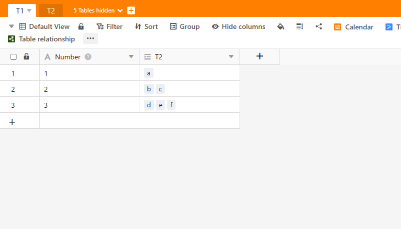

I want the code to perform the following task: It should review the records in Table T1 and identify the number present in each. If the number is 1, it should link to the first empty record in Table T2. If the number is 2, it should locate the first two empty records in Table T2 and link to them. And so on.
In essence, the code should read the number in Table T1 and, based on that number, link it to the corresponding number of unlinked records starting from the first available record in Table T2.

Hi Hossein, don’t apologize, it’s always pretty hard to keep a code crystal clear and easily understandable! Don’t save on comments, they can be very useful to return to an old job at a later date… I don’t really get the full connection between your first message and the second one, but what you’re trying to achieve is pretty straightforward for me in your second message, so here is a proposal. Unfortunately, I didn’t manage to use batchUpdateLinks (I got an error error: base.batchUpdateLinks is not a function which is pretty weird, maybe @cdb can help you on that specific point) so here is a version using updateLinks, but this can make a pretty huge amount of server calls depending on the size of your tables, that’s why it would be really better to use batchUpdateLinks. I defined as much as name variables at the beginning to make it easier to adapt to your use case.
