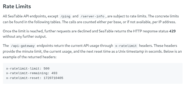

They are in the headers of the http responses that are returned by the api.
There’s no explicit api call to get to this information, it is returned in the response headers of every api call.
I don’t think for example the javascript api exposes this information.

The linked article contains one part of the answer to your qustion:
The second part is in this forum post: Get x-ratelimit-limit, x-ratelimit-remaining und x-ratelimit-reset from JavaScript-Client

Unless the api for your language exposes the headers in some form, you have to do the http get/post/etc. yourself to get to the headers.
curl -I (with a capital i) might be your friend.
Also I think I misunderstood your question.
In the headers you will find info on how many api calls are left before you are rate limited.
