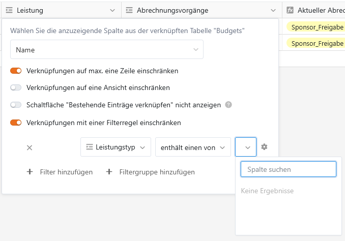

Option 2:
  • My link filters don’t allow for comparisson of linked columns. (I tried using dynamic link filters but there are no options displayed)

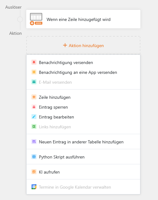

Option 1:
  • I cannot add multiple triggers to an automation
  • I cannot find a “find a record” action

  1. Option 1 (Automation): The “Add links” automation action is a feature available in specific plan tiers, and the action name previously mentioned was slightly inaccurate.

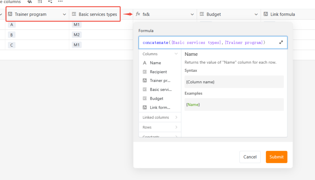

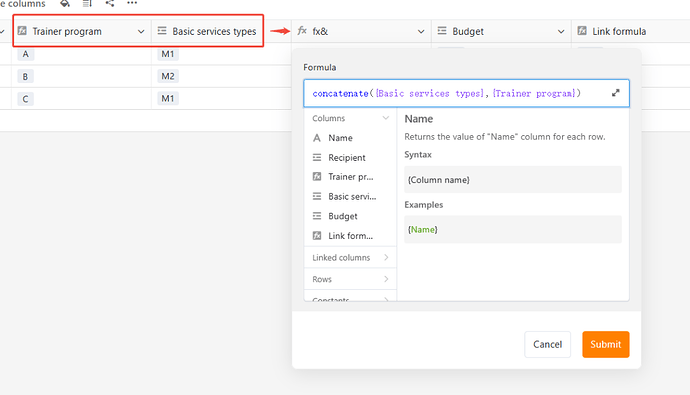

To achieve your goal seamlessly without writing any Python scripts, you can use a Composite Key (Formula Concatenation) method to establish the exact budget link automatically.
Step-by-Step Guide

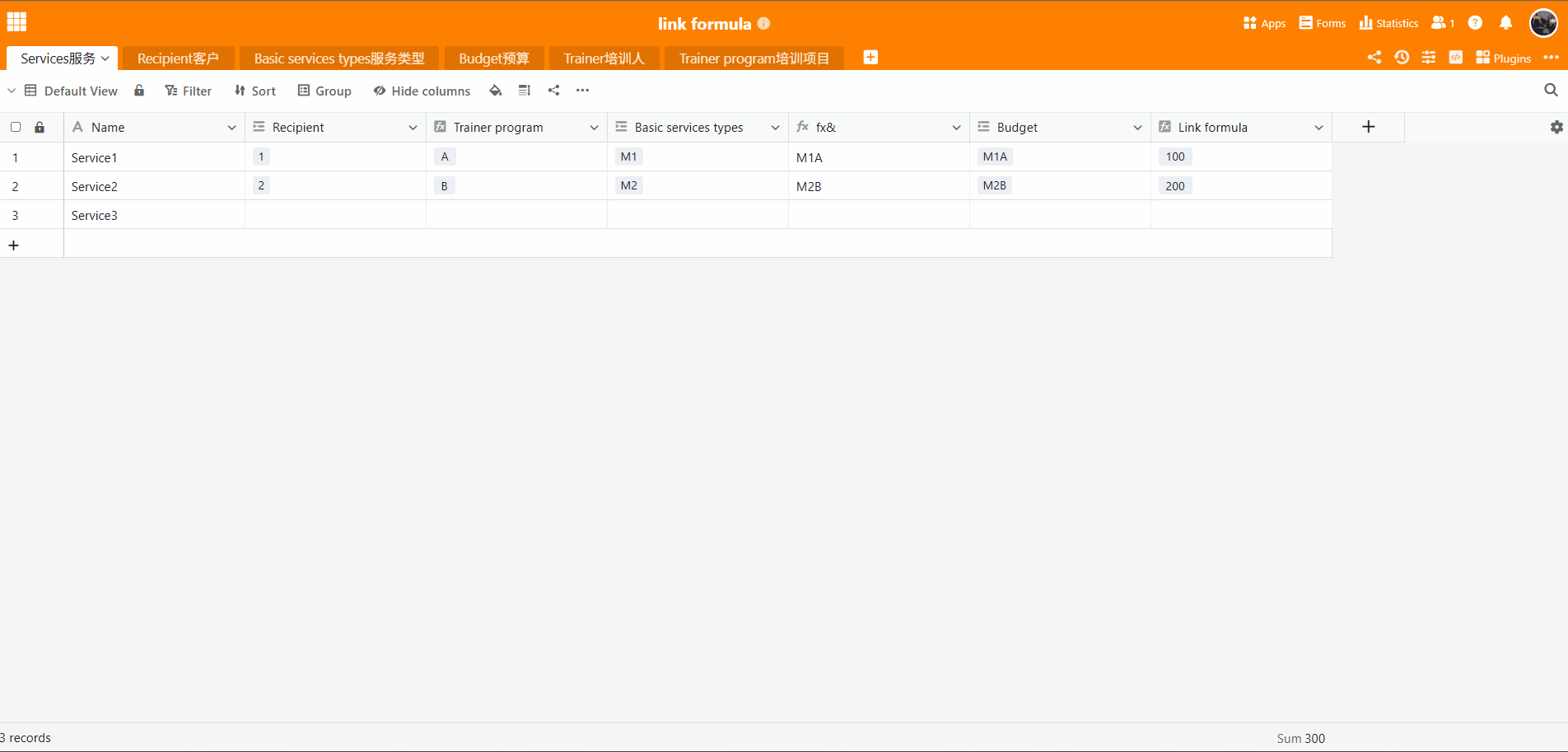

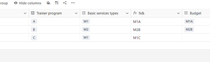

Step 1: Create Composite Keys in Both Tables
  1. In the Budgets table: Ensure your Primary Key column (Name) is a concatenated string of Program + Base Service Type (e.g., ProgramA_Meeting1 or M1A).
  2. In the Services table: Add a Formula column (e.g., named Lookup Key) that concatenates the Recipient’s Program + Base Service Type using the formula: CONCAT({Recipient->Program}, "_", {Base Type}) (adjust column names accordingly).

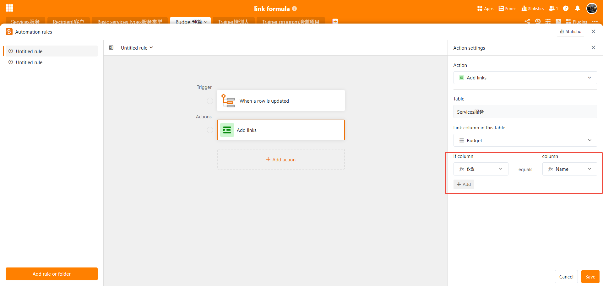

Step 2: Set Up the Automation Rule
Create a new automation rule in your base:
  • Trigger: When a row is added or updated in the Services table (specifically when the Lookup Key is populated).
  • Action: Select “Add links” (if available in your subscription) or update the link using the Lookup Key to match the corresponding Name in the Budgets table.
Step 3: Pull the Price with Link Formula
Once the link column to Budgets is automatically linked by the automation rule, simply add a Link Formula → Lookup column in your Services table to fetch the Price from the linked Budget row.
