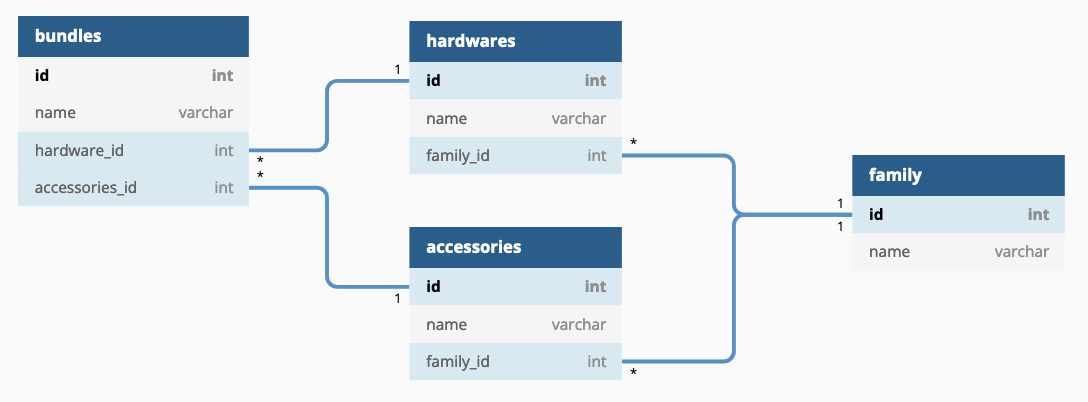

Very fast done, here’s a fake schema of my database.
What I try to achieve is : when I create a bundle, and when I have selected an hardware for this bundle, I want the list of the accessories to be restricted to the ones that have the same family than the selected hardware. I don’t know how to draw that… I hope it’s self explanatory.

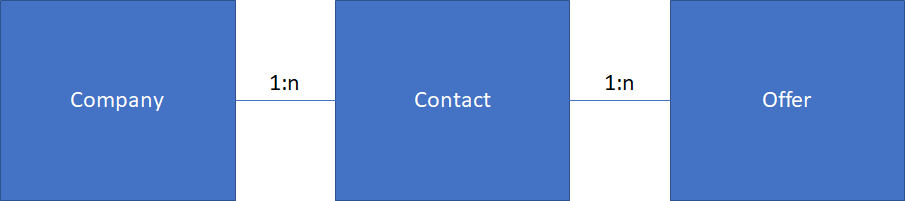

Hi there,
If I understand the original problem correctly, I have the same problem / request.
Here is an example of a simple company, contact, offer - relation.
In the last table the column “Contact at Customer” should be pre-filtered depending on the content in column “Customer”.
So in the example I would like to have the options pre-filtered to Company A, so I can only select Person 1, 2 and/or 3.

What you try to do it currently not supported. Sorry.
Yet, I suggest changing the data model. With a different (and imho smarter and cleaner) data model, you don’t need the feature.
Specifically, this is what I would do:
The database design:
The tables:
As you can see in the table “Order”, I lookup the customer name from the table “Company”.
And the cherry on the cake: When creating a link between contact and company, you can use the company name to filter the contacts. In the screenshot below, I enter the company name and the wizard only displays the related contacts.

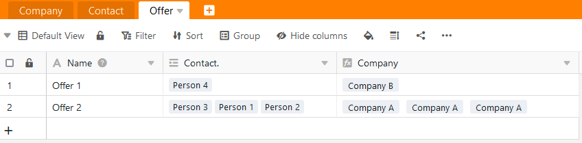

Thanks for the suggestion, that works and I will implement it like this for now - it does feel like a bit of a workaround though. :slight_smile:
Because I see two disadvantages:
In my original structure I could choose the company first and limit it to one company per offer but still link two or more contacts of that one pre-defined company.
Now if I want to allow more than one contact I could (by mistake) choose contacts from different companies. Which in my case isn’t crucial and will be noticed, but also not bulletproof, in my opinion.
Furtermore, when choosing multiple contacts of the same company, the company name is linked several times according to the number of links I created with the contacts.
Example:
Feature request:
For the “link formula” column an option would be nice to consolidate/condense(?) multiple entries if they are the identical. In this case show “Company A” only once in the row of “offer 2”.

@daniel.pan The current roll-up summary methods are all of the numerical sort (concatenation being the exception). Are there any plans for such a “consolidate” summary method to handle string data?
Removing duplication when showing entries in linked records is a niche need from my point of view. We don’t have such a plan yet.
In SeaTable 5.1, we’ll add such a feature.
