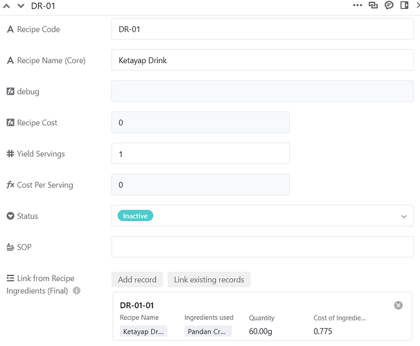

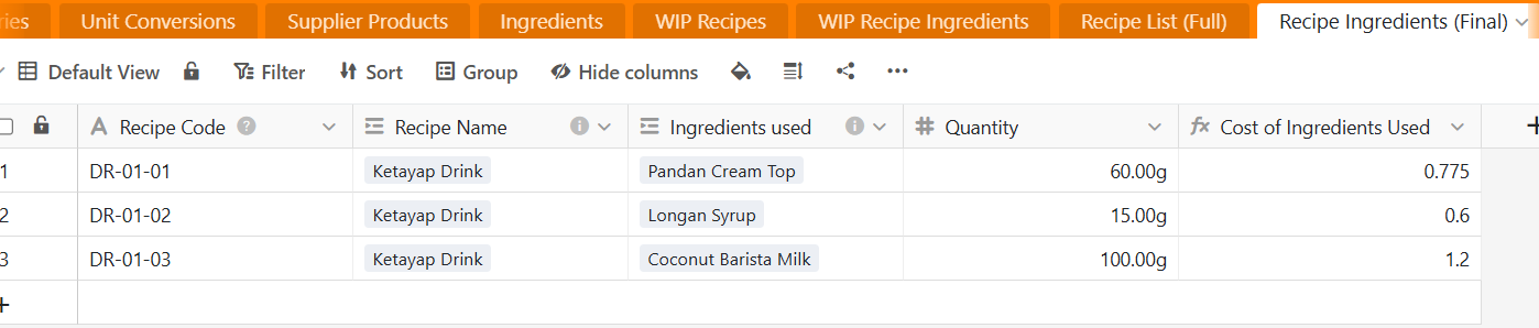

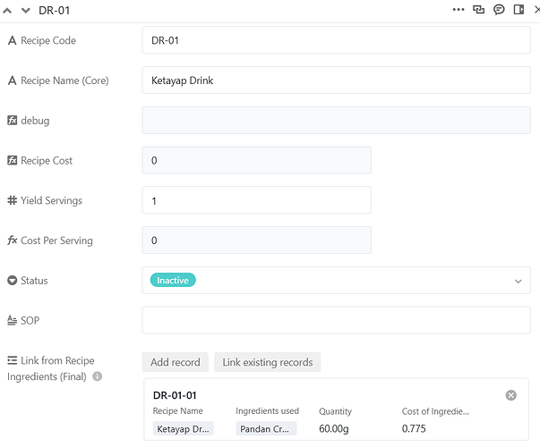

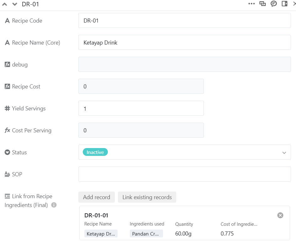

DR-01-01 cost is 0.775, and it should be pulled from Recipe Ingredients (Final) table to Recipe List table, but the cost here shows 0. Status does not affect any of the formula here so we can ignore that.

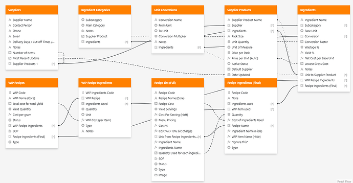

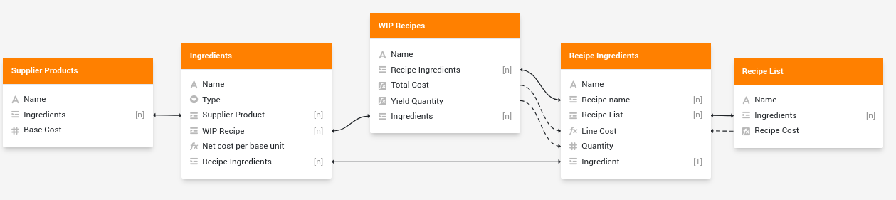

First of all, thank you for your effort to present your case as clearly as possible, I really appreciate that! However, I’m afraid I quite didn’t understand the whole process as I wasn’t able to reproduce your problem :sweat_smile:. In my case, I don’t get 0 but a #DIV/0! error in the Recipe Cost field of the Recipe List table.
Here is the global base structure I set up based on your description:
Please note that this screenshot comes from the table relationships plugin, and I’d really like to have the same from your base.
Here is why I get this error, which is something that doesn’t seem to work in your process:
  • In Ingredients table, for WIP ingredients, Net cost per base unit is calculated from {WIP Recipe.Total cost}
  • In WIP Recipes table, Total cost is computed (rollup/SUM) from Line cost in Recipe ingredients table
  • In Recipe ingredients table, Line cost is related to {Ingredient.Net cost per base unit}
=> There is no “entry point”

I struggle understand your base structure. As far as I understand it (and as I already said, I probably missed something!), here is the main process:
  • For “final” recipes, you calculate the recipe cost from the sum of single ingredient cost multiplied by its quantity
  • For WIP recipes, I don’t really understand how you want to the calculation to be processed: you have the global recipe cost, each ingredient’s quantity and you want to calculate each ingredient cost right? If it’s the case, your Total Cost in WIP Recipes table should be manually defined and not computed (rollup/SUM) from ingredients. However, you won’t be able to calculate properly each ingredient cost if you have several ingredients: you have one single equation that looks like global cost = ingredient1.cost * ingredient1.quantity + ingredient2.cost * ingredient2.quantity + … but you’re trying to find out several variables (ingredient1.cost, ingredient2.cost, …) which is not possible.
Please clarify the process for WIP recipes (what/how are you trying to calculate?) and share with us a screenshot from the table relationships plugin, it may help to better understand your problem.

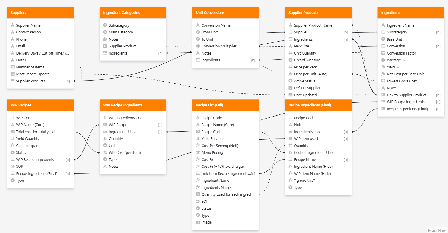

I currently fixed the issue with another workaround. Here is my current linkages.
I suspect that SeaTable have limitations to how many times 1 cell/column can be linked around. At this point everything is working fine, but If I create another table to calculate, lets say, Cost for takeaway items, linking from Recipe List (Full), some of the values that went through from Supplier products → Ingredients → WIP ingredients → WIP Recipe → Recipe Ingredients → Recipe list won’t make it to the new table “Cost for takeaway items”.
This is the same issue as previously when I tried to link some items from Supplier products → Ingredients → WIP ingredients → WIP Recipe → Recipe Ingredients → Recipe list → Costing & Margins, it shows value as 0 at Costing & Margins table, thus I combined the cost calculation in Recipe List and use different views to manage them.
