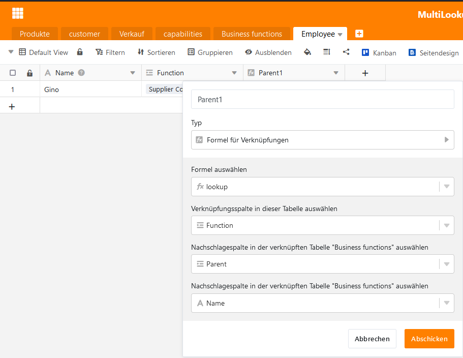

Ok, but my original request is still not solved. It was the request to use the lookup functions based on a previous lookup field. See the example:
Parent 1 is a lookup field
Now i need to add Parent2 and I need to lookup the value based on the value in field Parent1, and this is still not allowed
Here it should allow me to select the field ā€œParent1ā€ as lookup field. But it is still only allowed to select the link to other record column ā€œFunctionā€

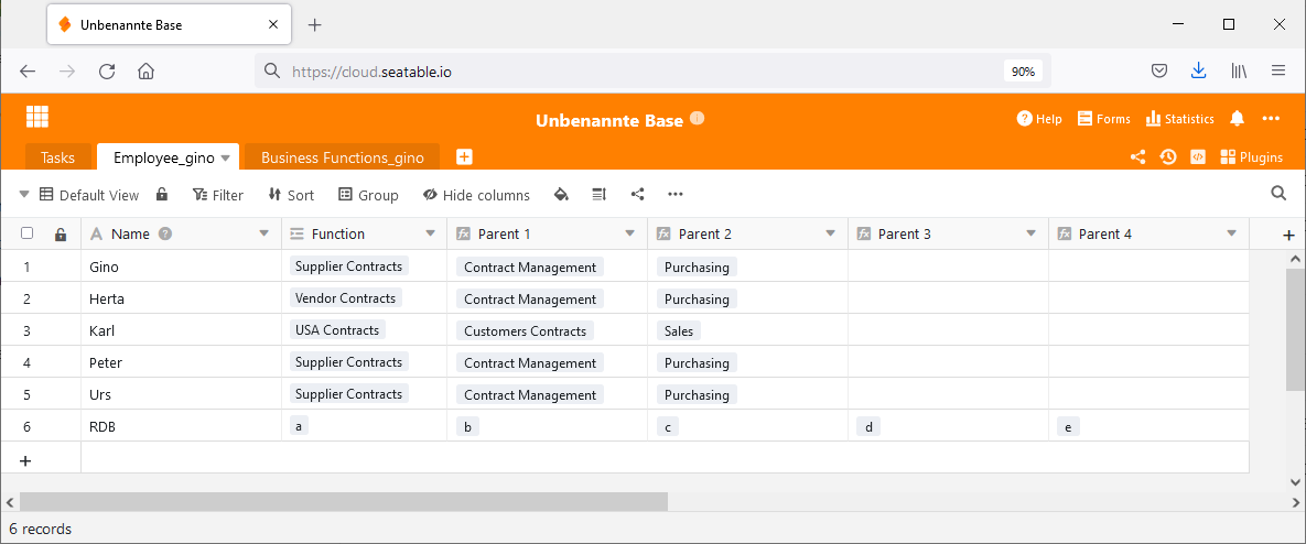

I read this and your previous post some 5 times, but I am still not sure I understand your requirement.
Based on my understanding of your job at hand, what you want is possible. Have a look at the table below.
You select the the function and SeaTable shows all the parents. Isn’t this what you want to do?
This is how I did it:
For this solution to work, every function has one (and only one) parent.

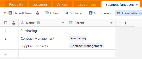

First, i have a table Business Functions
grafik
This table has only fields Name and Parent and here I can create structures as deep as i want, in this exampl we have 3 levels. 3. Level Supplier contracts, has Parent Contract Management on leve 2, which has his parent Purchasing on level 1.
In the next step I am trying to normalize this structure for each employee. I say that Gino’s function is supplier contracts, which is level 3, and then my whish is to automatically show the higher function levels, level 2 is possible with lookup, as input we have the function level3 (linked to another record) and it gives the contract management, but to get also level 1 I would need to lookup with the level 2 field, because I need the value Purchasing as result.

I am just a supporter, no developer: But I’d say that your request cannot be implemented.
In your second screenshot, you want to be able to select a link formula column where a link column must be selected. These column types are not interchangeable. In fact, they are kind of opposites: A link column creates a link, a link formula column evaluates a link.
You’ll need to restructure the table ā€˜Business functions’ as shown in my example.

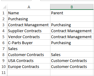

Here the same example in Excel, first the functions:

Exactly. this is what your table would have to look like to use SeaTable immediately for your use case.
I am not saying that SeaTable will never be able to do that. It may. My statement above was not an absolute one (and wrapped into the caveat of me not being a developer). But I am not aware of any plans to develop this feature.
You presented this as a feature request. Duly noted. My attempt was to present you a workaround that you can use today.
