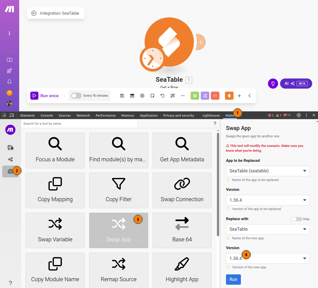

Still it seems that make.com provides a developer tool to update multiple versions at the same time. This is what I found in the community forum of make.com:
  1. Install the browser Extension “Make DevTools”
  2. Clone your scenario (for backup)
  3. Open your Scenario
  4. Open the Browser Console and switch to Make
  5. On the left side select Tools
  6. Use the function Swap App
  7. Replace SeaTable App with newest Version
The current version of the SeaTable App is v1.36.4.

I tried it and ran the swap app feature, but it turned out, that I’m already using version 1.36.4 of the SeaTable App, and therefore I’m still getting the deprecated error.
It is correct, though, that if I manually replace all modules one by one, it seems to be working.
