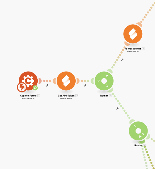

I’ll post a few screenshots to illustrate the process.
In my example I use Cognito Forms as a form server. Incoming form posts are forwarded to this make.com scenario.
In the first step you get the dtable_uuid, which you get via API call /api/v2.1/dtable/app-access-token/.
In the second step, you then execute the API call with the SQL query /dtable-db/api/v1/query/{{16.body.dtable_uuuid}}/, where {{16.body.dtable_uuid}} is the dtable_uuuid from the first call.

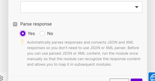

As described above, the easiest way is to use the radio button “Parse response” in the make.com HTTP module. Please read the explanatory text on the radio button - here the HTTP call must be made manually once (right mouse button “Run this module only”) so that the parser can “learn” the JSON structure.
Screenshot 2023-11-18 11.55.27
Alternatively, there is a separate JSON module in make.com that could also be used to parse the response. However, it has no advantages in this context and costs an extra operation in make.com, which can be saved.
