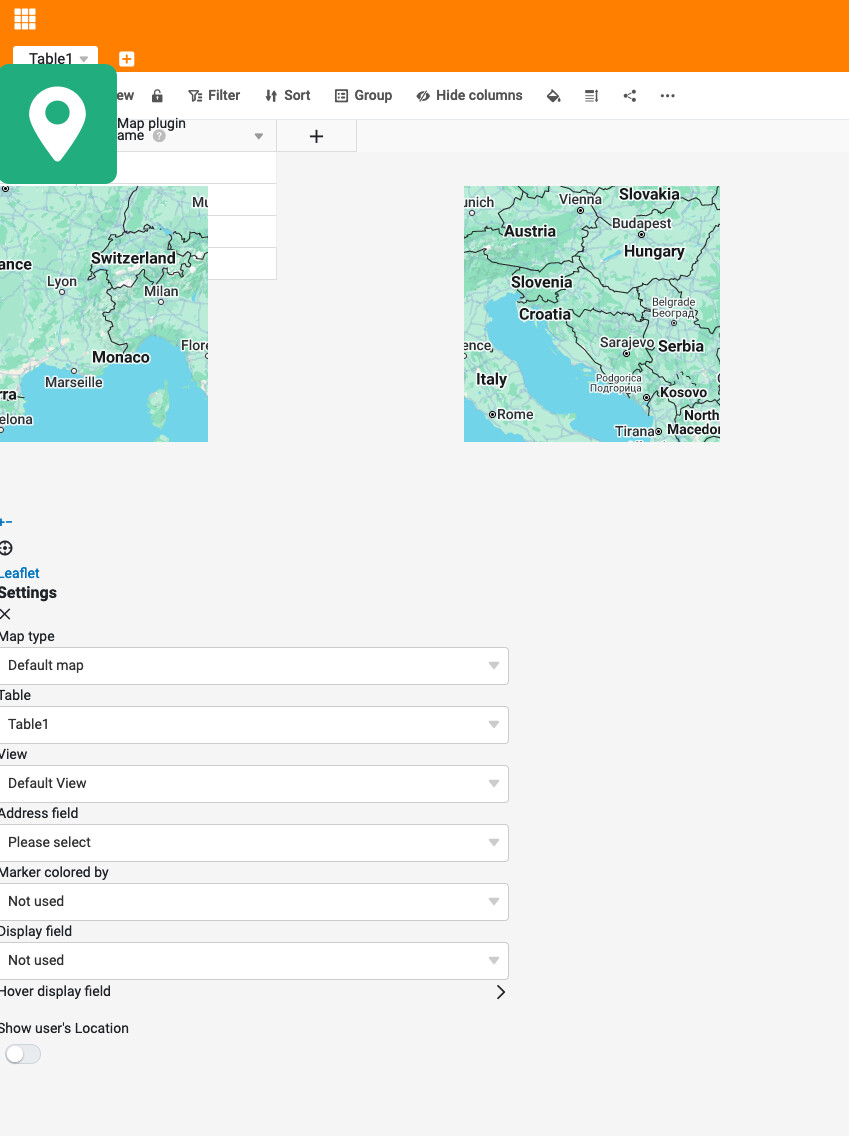

Please see the screenshot:
I thought that maybe I had overwritten with custom CSS, however I disabled all custom CSS and the problem persists. I also deleted the Map Plugin and reinstalled from the marketplace and it persists. It does appear that styles located here: https://…/dtable-plugins/map-en/?path=/media/main.css&t=1718898468000 are not working/loading. However, the stylesheet appears in the head and it othewise can be accessed directly. Any ideas?

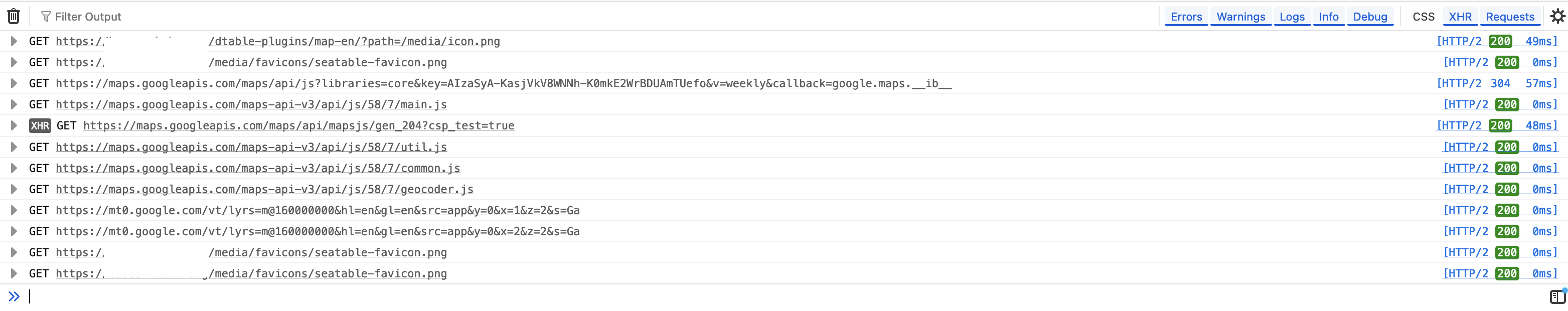

Does the browser console throw an error?
I have installed the plugin from the marketplace using Option 1 in the Seatable Admin Manual. It is version 0.0.46 and I am using Seatable EE 5.0.8. I am not seeing any console errors, here is a screenshot of console after clicking on the Map plugin button from a project.
I did a comparison of styles using the inspector with the Seatable Cloud, which is how i determined that the styles are not being applied. See the comparison screenshots.
Seatable Cloud:
Ours:
You can see that for the tag the .plugin-map-dialog-en .plugin-logo .plugin-logo-icon styles (amongst many others) are not being applied on ours. I even tried to copy and paste that entire stylesheet into my custom CSS however, that didn’t make a difference.
However the stylesheet where these styles originates seems to be active as seen from the head of our version:
Just to note, all the other plugins work fine, it is just the map one.

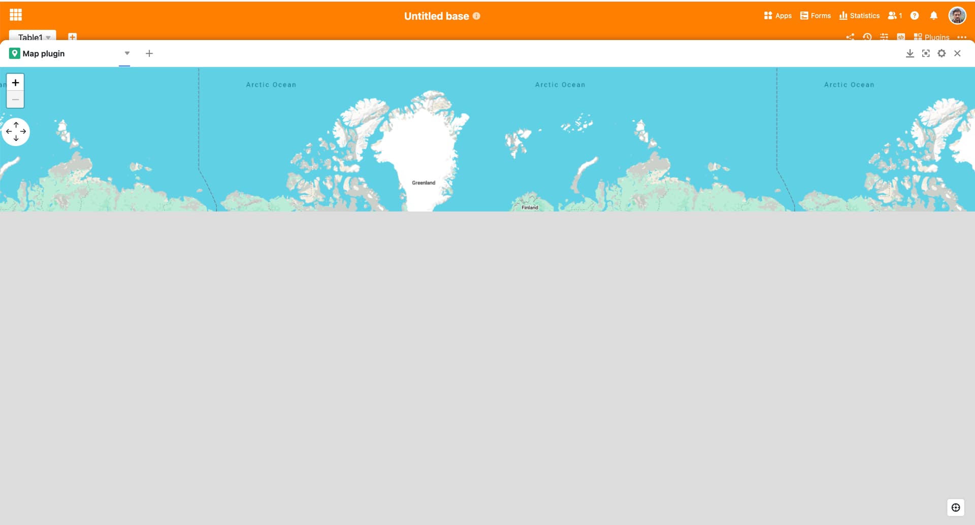

So I am not sure what happened, but the problem appears to have fixed itself. Perhaps there was some weird caching happening? At any rate, thanks for the help. The only other issue with the map plugin is that when it initially loads it usually (not always) only partially fills the window. However if you click the fullscreen icon twice (to go into fullscreen and back out again) it fixes itself. Just a bug i think, as this also occurs on Seatable Cloud.
