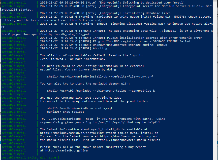

When I do docker compose up to install docker. I have this on my terminal.
And the mariaDB docker, or setable-mysql, does not launch.
Can you help me please ? I don’t have much knowledge in dockers
Couple of things:
docker compose, you do not install docker....
[Warning] mariadb: io_uring_queue_init() failed with EnOSYS: check seccomp filters, and the kernel version (newer than 5.1 required)
[ERROR] Unknow/unsupported storage engine
[...] Examine the logs in /var/lib/mysql/ for more information.

I work on my computer, it’s a Windows 10, with 16 GB RAM, the processor is an Intel(R) Core™ i7-8565U CPU
Do you run Docker on your Windows 10 machine? Windows is not a supported platform.
I have other docker and they work, I use powerShell to launch them the first time and the docker desktop application.
Hey AgaC,
SeaTable requires mariadb to start. If there is no mariadb, SeaTable will not start. There this is no SeaTable problem and therefore you will probably not get any help in this forum.
But google delivered this result: Docker Windows11 MariaDB - Docker Desktop for Windows - Docker Community Forums.
Check this out and try again.
