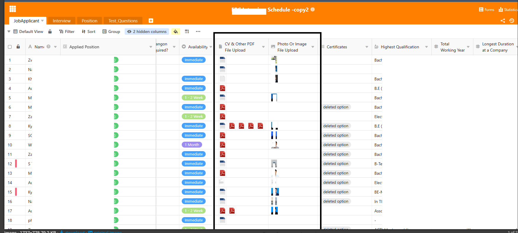

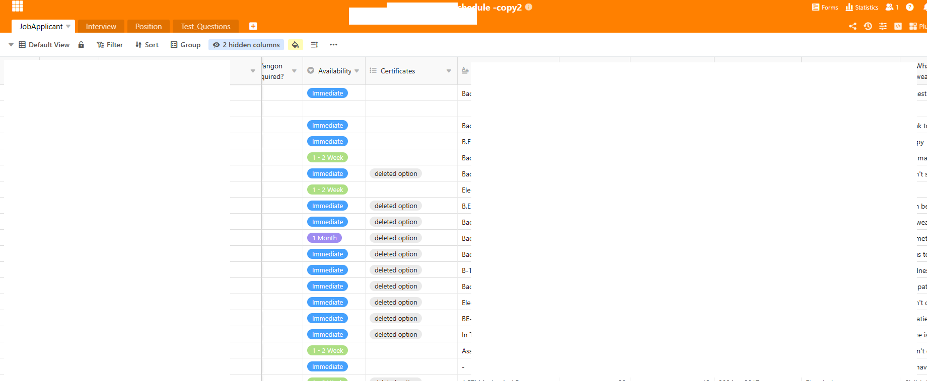

I will be deleting this 2 column manually by pressing “delete” button on my keyboard.
after i delete it and try to export the base, it give me the same error.
i try deleting the 2 columns, but i am getting the same error when export.

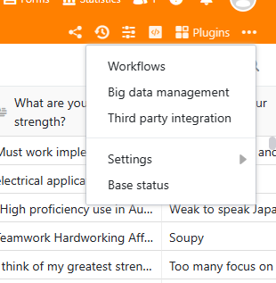

Please follow the instructions for this.
@fsa thank you for your guide…

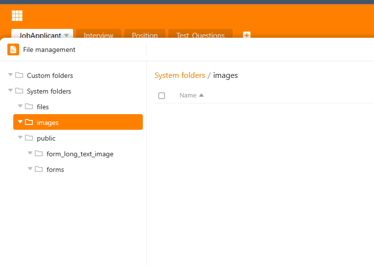

as shown above, i am unable to locate the file management as per manual.
However, i do manage to find it at the location shown below. so i guess it will solve my problem… :grinning:
Ah, I just saw on your screenshot that you are still using version 3.5. Our instructions refer to the latest version.
Nevertheless, I’m glad you found the menu. I hope it solves your problem.

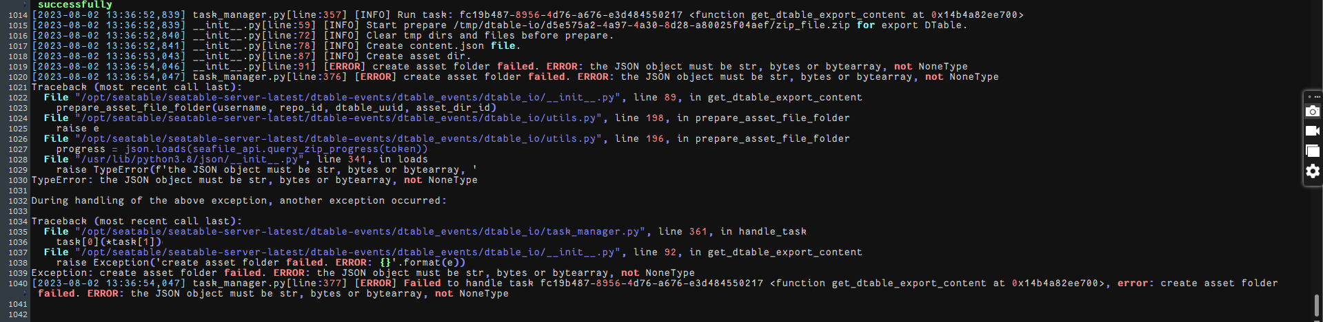

Can you check what error message you have in dtable-events.log and dtable_events_io.log?
hello, for dtable-event.log, i get the following error
for dtable_event_io.log, i get the following error.
please let me know if you require more information.
hello, i think the error is unable to create the folder?
I don’t know the exact cause of the problem in your server. But in version 4.1, we will ignore such kind of error and make the base content can be imported.
