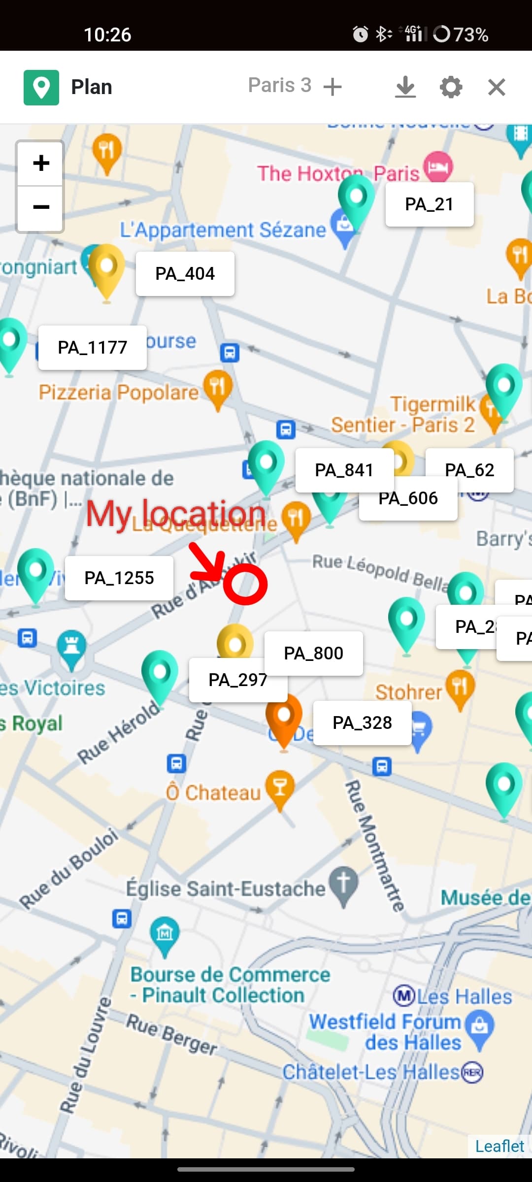

My question is : I want to see a point on the map wich show my live positon. See exemple attached (Red circle is me, green and yellow points are records in my base).
Thank you

Hi @Ruby_Kioube, I checked further the geolocation feature of the browser, and it’s definitely possible to do what you want.
I slightly modified my cartography script : you can now choose between three values for the curPos variable setting how you would like to display your current location on the map :
  • "no" which is relatively obvious I gues :laughing:
  • "static" which gets your current position only once when the page opens
  • "track" which will updates the marker’s position while your position is changing.
You can try the tracking options on this link showing you few restaurants in an around Paris (be aware that the map centers on the markers, not on your position).
