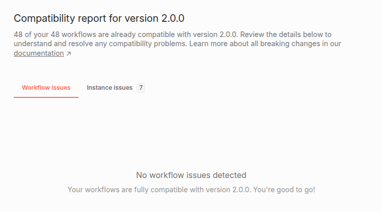

In addition to @Ben’s recommendations, I suggest first upgrading to the latest 1.x release (v1.123.10 ). Then, open the Compatibility Report (n8n → Settings → Migration Report) to ensure your setup is ready for the major version jump.
Here is how it should look like:
Once everything checks out, proceed with the upgrade to either the latest version or 2.2.3 (current stable).
Please make sure you check the Instance Issues too because they can also break stuff if you ignore them. This is something that could be updated in the compose file. :wink:
