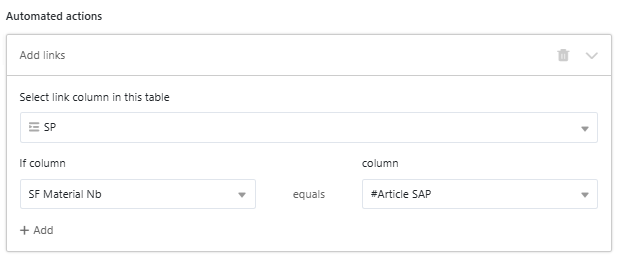

Hey,
Do you know a workflow in n8n that can replicate the Seatable Automation Rules to create a Link between 2 tables based on matching values in each table ?
This is basically to perform the automation rule in the background.

Hi @PeFlam,
I currently use such a workflow, the process is pretty straight-forward:
Please not that this actually works only il the search term is unique (meaning that your row: search action will never returns more than one item)
