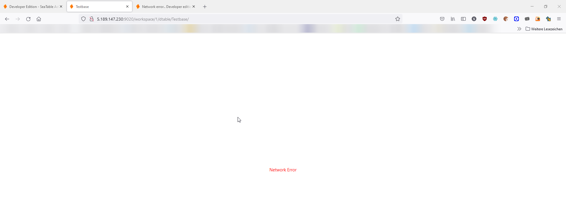

But as soon as I want to open this base a “Network Error” appears…
Running the developer tools the debugger shows these two errors:
Quellübergreifende (Cross-Origin) Anfrage blockiert: Die Gleiche-Quelle-Regel verbietet das Lesen der externen Ressource auf http://5.189.147.230/dtable-server/dtables/6d8e0c57-5843-4441-b6ff-9f5b5029e022?lang=de. (Grund: CORS-Kopfzeile 'Access-Control-Allow-Origin' fehlt). Statuscode: 200.
Quellübergreifende (Cross-Origin) Anfrage blockiert: Die Gleiche-Quelle-Regel verbietet das Lesen der externen Ressource auf http://5.189.147.230/dtable-server/dtables/6d8e0c57-5843-4441-b6ff-9f5b5029e022?lang=de. (Grund: CORS-Anfrage schlug fehl). Statuscode: (null).

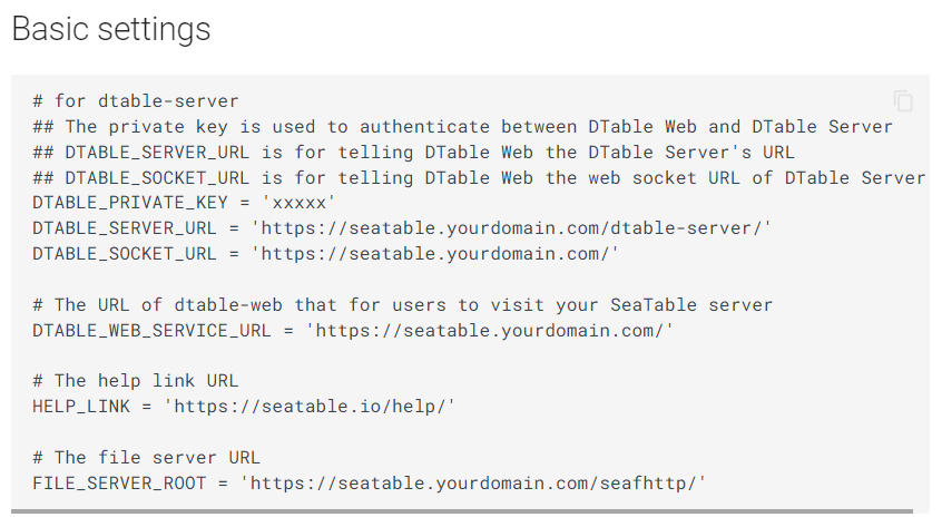

The interface you see is on the so-called dtable-web server and the bases are stored on dtable-server. So when you can see the interface and can create a new base, it means the dtable-web is running OK. However, in your case, the access to dtable-server is blocked due to CORS problems. The cause could be, that you use a custom domain but didn’t specify the dtable-server address separately.
I see you are using a custom domain:
Did you specify the dtable-server domain in the dtable_web_settings.py?
You should change this line:
DTABLE_SERVER_URL = 'http://5.189.147.230/dtable-server/'
dtable_web_settings.py - SeaTable Admin Manual

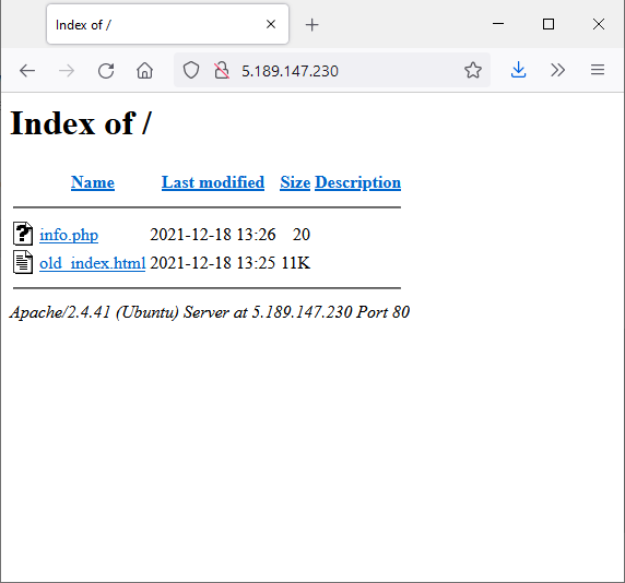

This is what I see when accessing the IP address:
Why is there an Apache answering?
How’s the Apache configured?
How’s the Nginx configured - the one started by the Compose file?
Oh, sorry, I should have mentioned that the seatable docker listens on port 9020.
The Apache is running because Contabo offered an Ubuntu system with or without LAMP. If this is a problem, I could reinstall without the LAMP. That is no need for me.
