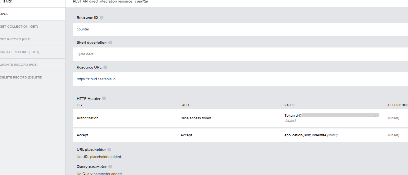

Trying to authorize my app (right now the app builder) to access the database rows for read and write.
So I’ve input the base URL https://cloud.seatable.io and the 40 char “access token” I created from my web interface (along with/without the Accept: application/json; indent=4 header)
But I get the “error_msg”:“you don’t have permission to access” Status 403.
In my GET collection interface, I’ve followed the doc Introduction GET List Rows and added the relative path to the base URL:
GET /dtable-server/api/v1/dtables/650d8a0d-7e27-46a8-8b18-dbvh46/rows/?table_name=Table1 HTTP/1.1
Authorization: Token eyJ0eXAiOiJKV1QiLCJhbGciOiJIUzI1NiJ9.eyJleHiOjE2MTQzNTI1OTQsImR0YWJsZV91dWlkIjoiNjUwZDhhMGQtN2UyNy00NmE4LThiMTgtNmNjNmYzZGIU3IiwidXNlcm5hbWUiOiIiLCJwZXJtaXNzaW9uIjoicnciLCJhcHBfbmFtZSI6InBvc3RtYW4ifQ.4aTmvBfFElyB3xg5jjF7zWCiyRZI17SZD980GdHT6e3
What am I doing wrong? What is this authorization token? It is Is it mine or an example? Same for the base_UUID, is it mine? If not where can I find it?
Hey fredkzk,
I am sorry that you have problems to get access your base via API. We tried our best to explain it at Introduction. (search for the headline “how does authentication work”).
Let me recapture how the SeaTable-API works:
  • seatable API differenciates between “base API” actions and “non-base” API actions
  • for base API you need a “base access token”
  • for non-base API you need a “access token”
There are two ways to get a base access token.
normal way
  1. go to the webinterface of SeaTable and generate an API token for a base.
  2. use this api token and generate a base access token via API (this is the API call for that: Introduction)
full API way
  1. generate auth token via API with username and password
  2. use the API to generate a base API token (use the auth token from 1.)
  3. generate base access token via API like in the normal way
Keep in mind: a base access token is only valid for 3 days.

Thanks Chris,
I did end up understanding - after a few days - that I needed to generate an access token with my API base token.
Once I got this figured out, I ran into the famous CORS issues. Imagie the cold shower… :expressionless:
