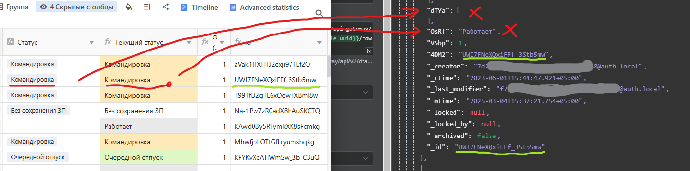

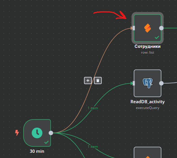

Hello everyone! I use SeaTable Self-Hosted version. v5.1. The problem is not in the SeaTable, but in the node n8n (i use Community node). This happens on the first node of the n8n pipeline — node outputs erroneous data.
The data in the other columns of these rows is updated normaly. Can you tell me what could be the reason?

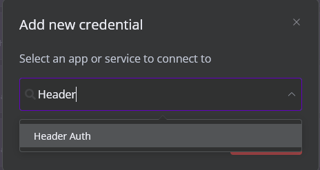

Create “Header Auth” credential with the API Token from the seatable GUI:
Give it a name, type “Authorization” into the “Name” field, and “Bearer ” into value (without <>" of course)

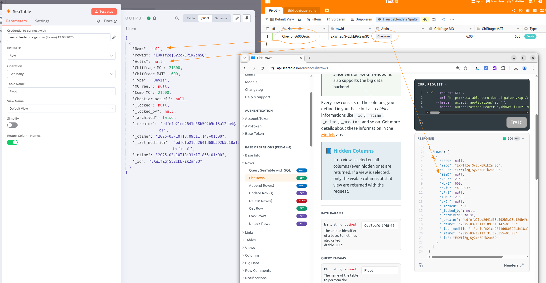

Hi everyone,
Let’s see what the script returns for @eash, but I think I just encountered a pretty similar problem (which I was unfortunately unable to reproduce on a simple unit case):
  • tested on SeaTable cloud
  • tried from n8n, api.seatable.io, the python pipeline from inside SeaTable cloud and the seatable_api python library
I have a table with several link and formula columns. While getting the content of the rows using list_rows, some of these formula and link columns are empty (returns None for python or null for api.seatable.io or n8n). While using @rdb’s script however (with context.current_row), I get the data for the considered row.
  • Python and JavaScript base.query functions and the SQL query plugin from inside SeaTable lacks the same data (the plugin returns the rows with these columns empty)
  • JavaScript base.getRows function returns the data correctly however
When exporting the table, data are present. While looking at the content.json inside my dtable export, I realized than the content for the first (0000) column (formula type) are either null or even not present, and the data from the other problematic column (link type) are completely missing to.
Any clue ? I haven’t gone through all my processes again to see which ones are affected, but it’s rather worrying :thinking:

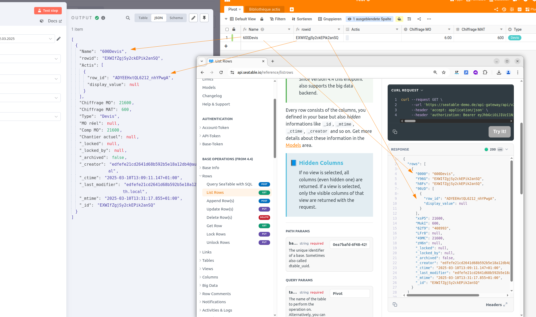

Hey guys,
I analysed the problem and I found the root problem for the strange API behaviour.
What is the problem?
API, n8n and python return empty values for some of the link-columns or formula.
Root cause

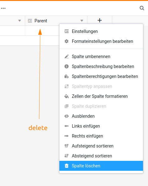

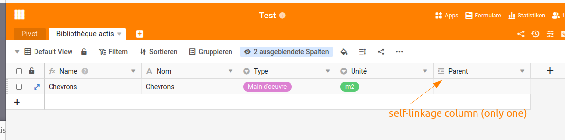

With 5.2, the behaviour of the link-column was updated regarding links to the same table. If you link to the same table, there should be two columns created. As you can see here, “Parent” is linking to the same table, but there is only one column!
I don’t investigate further, but I assume this is also dependent of “formula” in the first column.
How to fix?
Delete the link column Parent.
Result
API, n8n and python now return the correct values
How to identify problematic columns?
Use the table relationship plugin to identify link columns, that link to the same table again. Then check, if there are two link columns.
Next steps
I have to further investigate with the developers what is happening here! I fill follow up soon.
Hi Christoph,
Thank you for your answer! I deleted the single link column and re-created another one (so a second one was actually created) and everything works fine.
