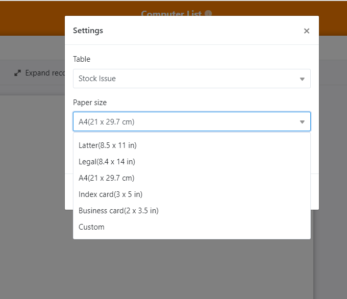

Hello , I am trying to create a report for Rows using A5.
as we can see, the default size of paper comes in “inch” unit.
However, when we choose custom, the number looks totally different. ( 794 x 1123 )
May i know which unit does 794 x 1123 represent?
Secondly, ability to change page size for existing template will be added feature. Currently, while we are creating a template , some time page size which we have selected originally does not fit all the records and we have to recreate a new template and restart everything again instead of changing page size.
Thanks for the report! Before anyone could answer the unit question (My guess: it’s Points), I’d like to point out that the “Letter” size has been misspelled as “Latter”. This issue has been reported.

if anybody know the answer, please assist to post here… I would like to create a A5 size template… but i do not know which size to use when using “custom” option
The custom size is defined in pixels.
794 x 1123 is A4 (a ratio of 1.41).
Hence 397 x 561 is A5.
