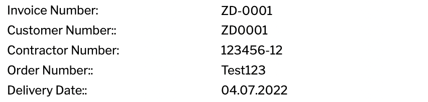

This is how the preview within the Page Designer plugin looks like:
And this is how it looks on the exported PDF:
As you can see, some fields work just fine and others trigger the bug without any recognizable pattern to it.
