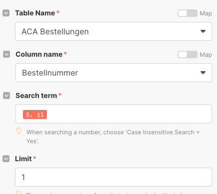

  2. The result (an order number) is used to find a specific row in a table using the “search rows” module from ST Rework. See screenshot:

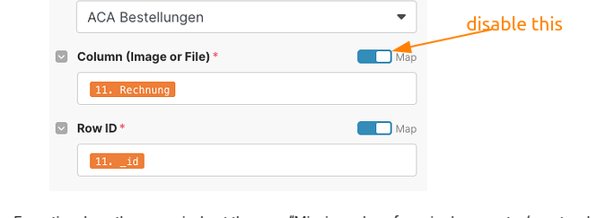

  3. The row ID returned from step 2 is used in “Upload a file/image” module to identify the row where the file is to be uploaded to the “Rechnung” column. See screenshot:
Every time I run the scenario, I get the error “Missing value of required parameter ‘asset_column’.” in the “Upload a file/image” module scenario.

Hey webdienste,
Please deactivate the “MAP” button for “Column (Image or File)” and select the column manually:
In fact, the make.com app will expect a value like <column_name>__<column_type>.
Best regards
Christoph
Hi Christoph,
That solved the problem. Thanks!
