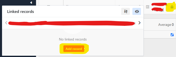

Then the fact that I can add a record is a bug? It benefits me in this case so it’s good. (see in yellow)
