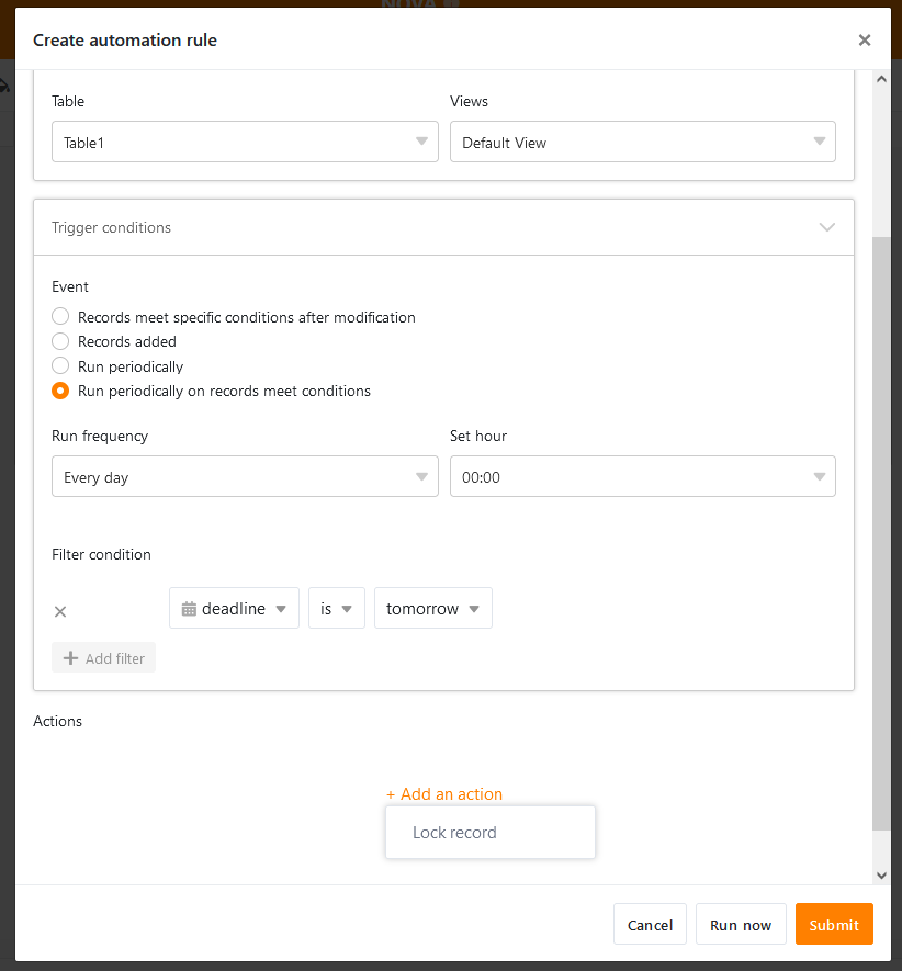

Still, I think what I need is not possible: I’d like to watch a column every day at 00:00 and if the date (deadline) is on the next day, I’d like to receive an email. But the only action available seems to be “lock record”. Maybe the “send email” action is not compatible with the “run periodically on records meet conditions”?

It is possible. You discovered an issue in the automation wizard.
Choose as Event “Records meet specific conditions after modification”. Add the action “Send email”. Then change the Event to “Run periodically on records meet conditions”. That should do the trick.
Let us know!

Sending email with trigger “run periodically on records meet conditions” is not available yet for some performance reason.
But it will be available in version 3.2. Only the first 50 rows that meet the condition will trigger emails, but this should be enough for most use cases.
At this moment, you can use notification rule to achieve the same thing. A notification that not read within 1 hour will trigger an email notice.
