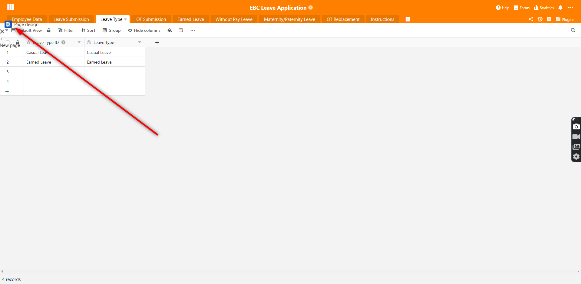

Hello, I think there is some problem with page design plugin. When i press on plugin, it show a transparent background with only page design logo in the left.

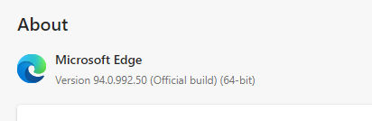

@rdb yes, i have uninstall and reinstall the plugin. I am using self hosted. browser is Microsoft edge.

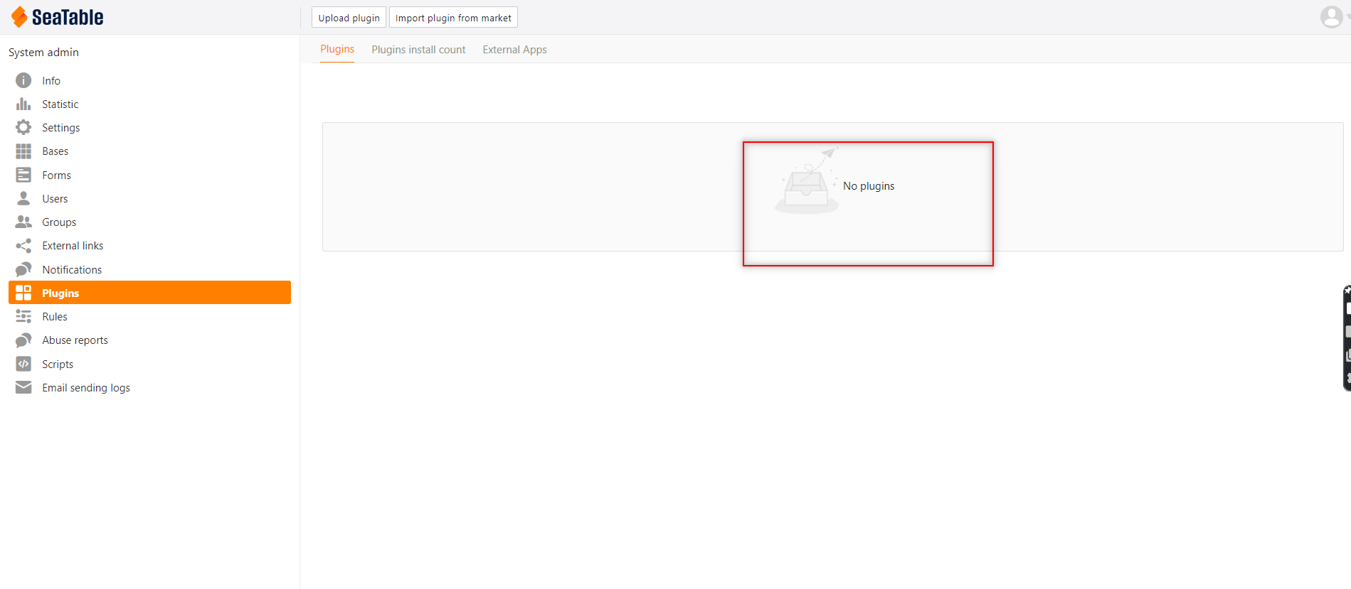

I have removed all plugin at “system admin”

anyway , after i remove all plugin , reinstall all of them, they are working well. even the page design download pdf is working. :star_struck:
