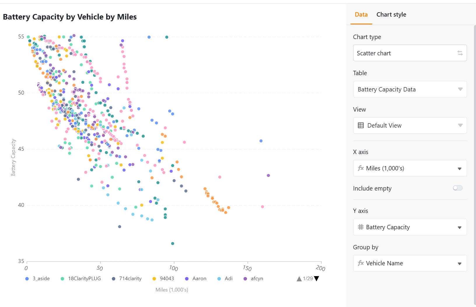

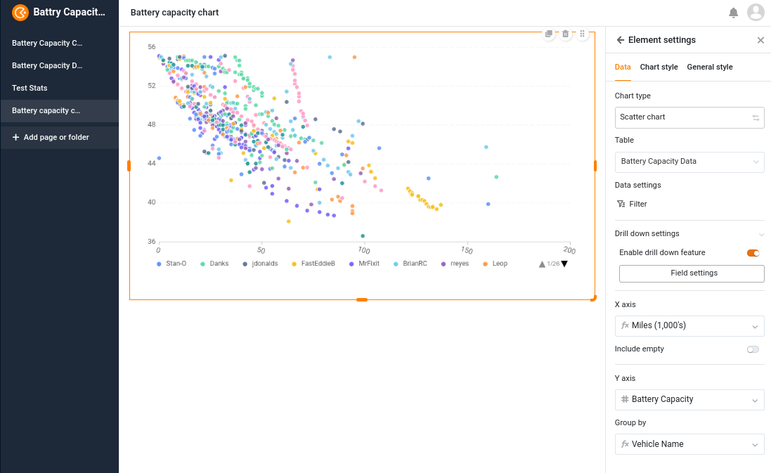

Problems with statistics in the Universal App. Attaching screenshots of statistics from the base and statistics in the Universal App.
Problem 1. Incorrect Y axis title.
Problem 2. Crazy X and Y axis values
Problem 3. Chart isn’t even close to the same statistics generated from the base.
Problem 4. The app pulls statistics directly from the table, not from a view.

The diagram in the app obviously uses different data. You said it yourself: The y axis is wrong. I’d add: The number of categories on the x axis is also off. In the base, you have 29 + 7. In the app, it’s 56 + 4 (or so). The exact numbers do not really matter because the numbers are so far off.
Did you give the scatter plot time to refresh after modifying its settings?
Could you share the dataset - in its entirety of part of it. Please send a XLSX/DTABLE export to support@seatable.io.
Views exist in bases. They are a foreign concept in apps.
The diagram in the app does not use different data. Both use the same table. The base version uses the Default View of the table. I can’t tell what the app is using, but it is the same table.
Yes.
We’ll escalate to the developers.
For now, unfortunately, I cannot provide a workaround but to use the statistics in the base.

We’ll fix the issue in version 5.3.

This is what your scatter plot looks like in our development system.
SeaTable 5.3 will be available soon.
