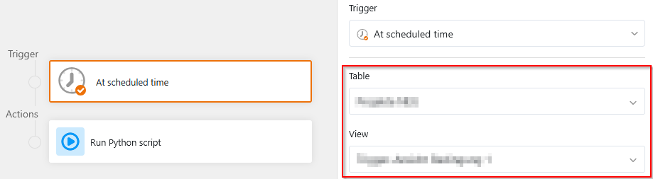

I’m running a python script from a time-based automation every night. Everything in the script (View Name, Table name) is hard-coded, which limits how often I can re-use the script. That is just an efficiency problem. On the other hand, according to Context - SeaTable Developer Manual , context.current_table is populated, but current_row is not.
Can someone quickly clarify the current behaviour? Specifically:
  • Does “context.current_table“ come from the setting of the automation?
    • If it isn’t, where does the table name it come from? Is it reliable in a automation context?
    • If it is, is there a way to access the name of the view which the automation is running on as well?
  • Am I right in assuming that the script runs only once, and needs to iterate over all the entries in the view? That’s why context.current_row is not set?
I’m trying to run python scripts with as little as possible guesswork about the context they have been started in.
An automation rule using the trigger “At scheduled time” has the current_table info in the context object.
By contrast, the trigger “At scheduled time” (as opposed to the trigger “At scheduled time for records matching condition”) does not make reference to any row. Hence, the current_row information is not available in the context object.
The context object does not have the attribute current_view, regardless of the automation rule trigger (Context - SeaTable Developer Manual).
