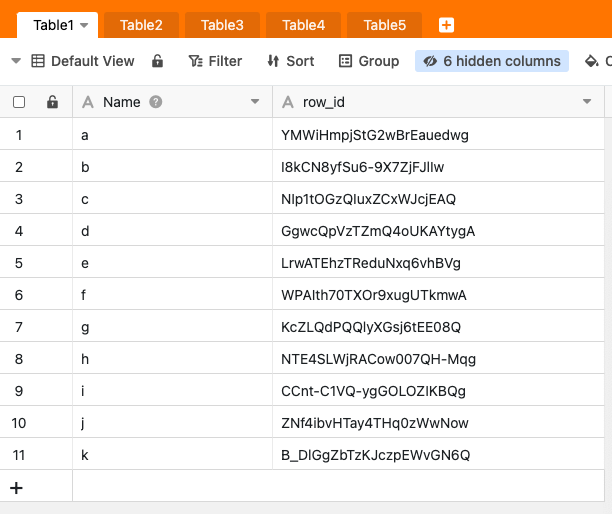

It can be accessed via row[“_id”] in scripts, but can’t be displayed in the UI.
A practical work-around would be, let the script write each row’s ID into a column.
For example, you can use this following script for Table1, Default View:
const rows = base.getRows('Table1', 'Default View');
for (let i=0; i<rows.length; i++) {
base.modifyRow('Table1', rows[i], {'row_id':rows[i]._id})}
So each time you run this script, it fills the column “row_id” with each row’s ID:
