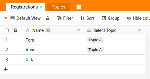

Here is how I would do that:
this is my super simple table for the registrations. The users just add their name and select a topic.
The magic comes from a link column which is limited to a view
To achieve the desired result, this view should show only the topic if there are less than 3 registrations.
Nothing easier than that. Just count the number of registrations and then add a filter
As soon as three persons selected the topic via webform the topic is hidden in this view and the next person cannot select this topic in the webform.
Does that solve your problem?
