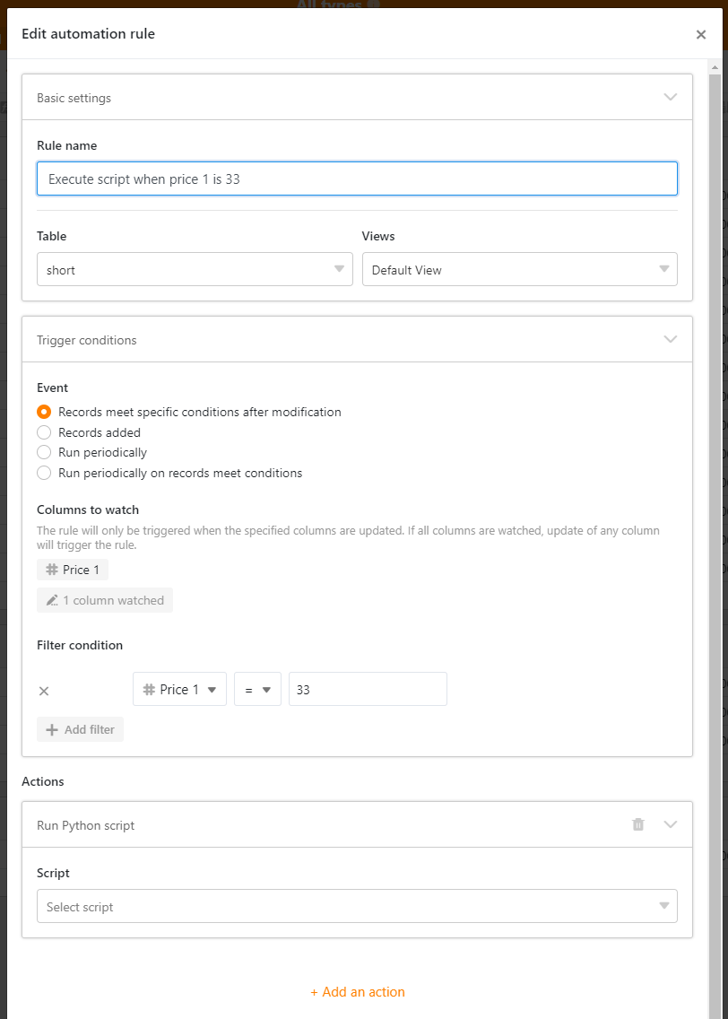

The most comfortable (but not free) way is to use the automation rules, where a Python script will be executed when a filter condition is met. As it’s fully automatic, the processing will be carried out as soon as a row fulfills the filter. This feature is but a paid feature in the Enterprise plan.

Thanks for clarifying… very useful to know about the automation rules in the Enterprise plan. For the moment, I will experiment with the idea of writing a filtering function.
